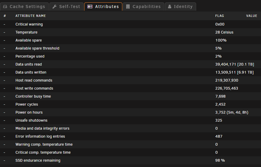

4.5+ GB written to cache per hour
I am running Unraid v6.12.9
I only use the cache drive for docker.img and storing app data, so I can't figure out why it's writing data constantly 24/7. The actual total data used on the drive is static, and the drive is not actually filling up, just wearing the SSD endurance down. My guess is overwriting existing data with the same data?
The docker containers should only be writing log files, no transcoding or anything intensive takes place on the cache drive.
6.91 TBW @ 3,752 Power on hours
7.55 TBW @ 3,893 Power on hours
In 141 hours, 0.64 TB of data was written to the drive, which is roughly 4.5 GB per hour
