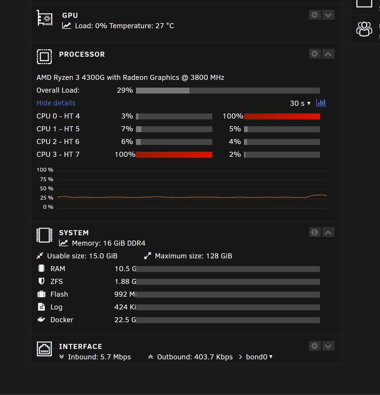

Further to my original post this has happened again...twice!  Strongly suspecting docker is killing the box.  I can log into dashboard but restart/stop array functions don't do anything.  Hard reboot only way to recover.
Screenshot of dashboard (attached) shows no graphical highlight bars and 2 cores maxing out (?)
Syslog of period also attached (died somewhere between 00:00 and 06:53 on 9-Apr: syslog.txt
Dashboard:
