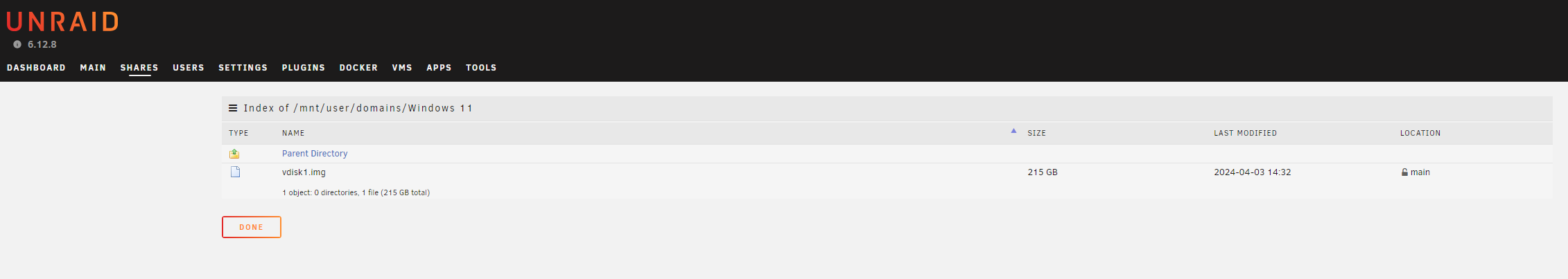

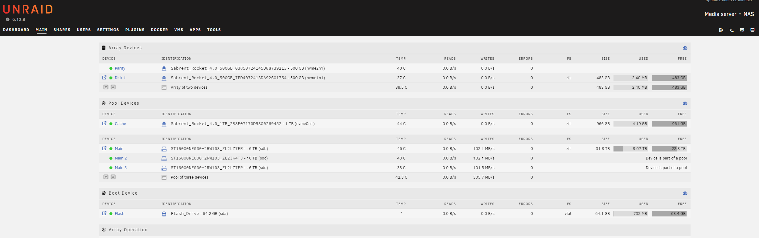

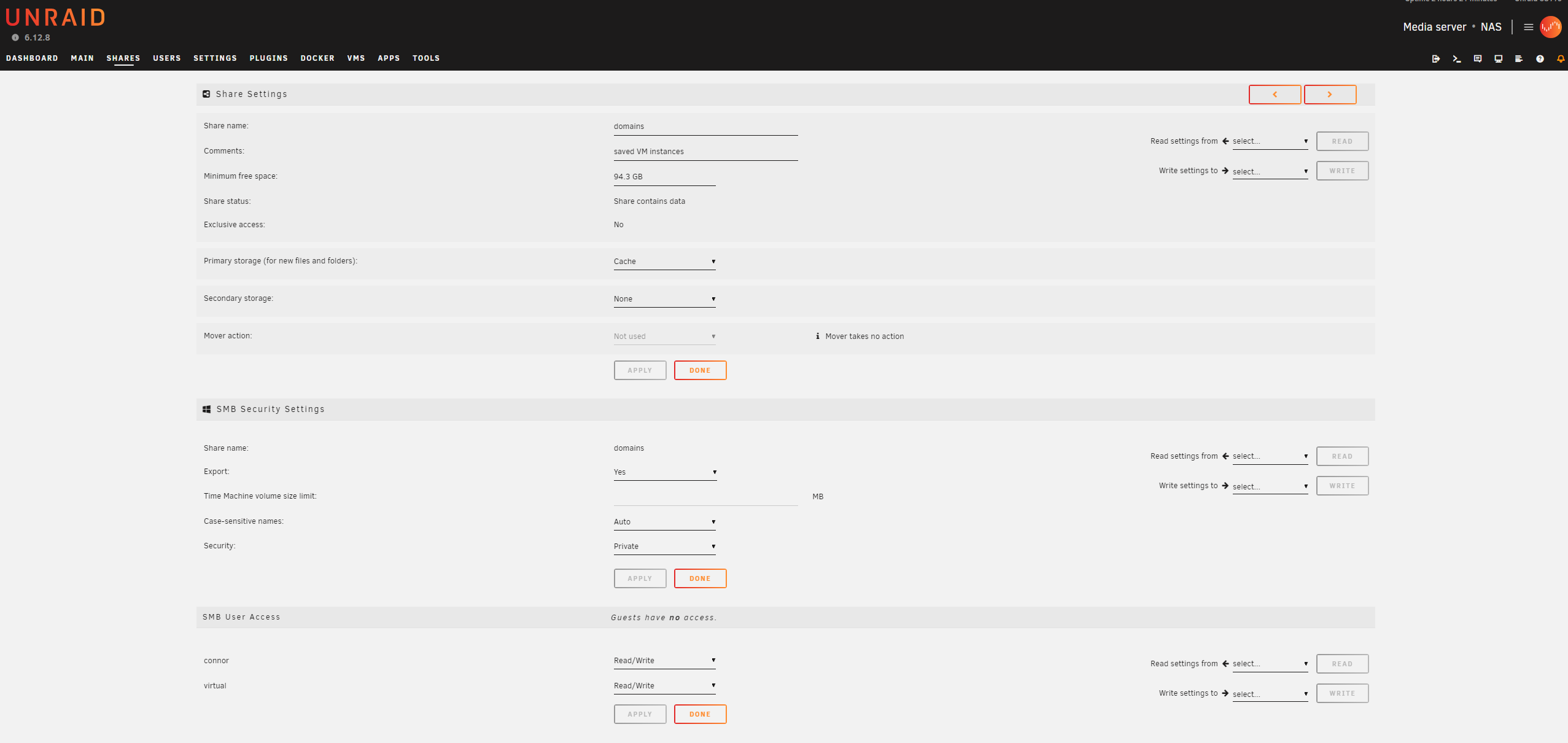

Still rather new to unraid so forgive me here. I am doing a backup of my main pc to my unraid server and whilst doing this I booted my VM which was very sluggish, I checked task manager and it said HDD 100% which was cause for concern, so I shut it down and checked my shares and when I go into my domains share it says vdisk1 is on "Main" which is my ZFS pool. As far as I am aware I dont think its possible to move from a zfs pool to a cache is it? If so how do I do this? I have attached some screenshots below to demonstrate what I mean
All I want to do is have my VM run solely on my cache for performance if possible as I have set a 200GB size and will mainly use it for converting videos which will be moved straight over to my main pool.

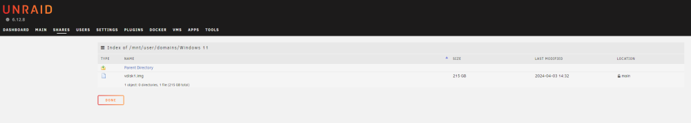

Also I just tried the mover, set primary storage to main on the domains share and secondary to array. Then set mover to do main - Array, and then ran the mover which ran for a few seconds but I am still seeing the vdisk1 listed as being on main
Did you shutdown the VM? If yes enable the mover logging, run the mover, post diags.

Apr  3 16:49:39 NAS move: move_object: /mnt/main/domains: No space left on device
Minimum free space for the domains share is very high, because it was on a much larger pool, default is 10%, you need to set a new appropriate value and then run the mover again.
