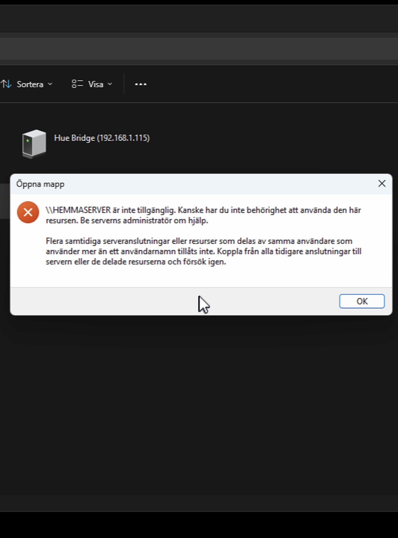

Hi guys, I have been trying to troubleshoot for hours, searching Google, YouTube, etc. but I can’t get it to work. I have my share in unraid set to private and my user has read/write permissions, then I go to file explorer and see my unraid server called “Hemmaserver“ but when I click on it this error message pops up:
“\\HEMMASERVER is not available. Maybe you don’t have permissions to use this resource. Ask the server’s administrator for help. Multiple simultaneous server connections or resources that are shared by the same user that uses more than one username are not allowed. Disconnect all previous connections to the server or the shared resources and try again.“
-Directly translated from Swedish to English as best I could.
I am using the tailscale plugin in case that is important and I am using the latest windows 11 version and unraid version 6.12.9

Windows will allow only one connection from a Windows client computer to any server.  (As I understand it,this is strictly a Windows policy!)  There was a backdoor where you could use the IP-Address of a server and the server's Network name to set up two connections.  BUT I have not been able to get that to work for some time.
Windows also has recently implemented a policy that guest/anonymous connections to servers are not allowed.
Window networking error messages are confusing and often misleading.
Many folks try to get around Windows security policies and sometimes, they are successful.  But, essentially, they are just hacking Windows security and MS may plug these hacks at any time in the future.  I feel that it best to just set things up the way MS wants them to be.    Here is a link to a couple of PDF files that will help you do this:

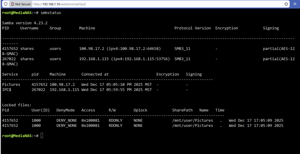

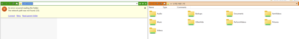

Below is a screen shot in my dual pane file explorer of it failing by server name and succeeding by IP address; sometimes, even IP address will not work. Clicking on Connect results in nothing unless I delete the MEDIANAS credentials from Credential Manager. It then prompts for user name and password and, far more often that not, still fails to connect. All these shares are Public.
Here is what smbstatus shows for the above. I am not sure where the locked files come from and if they are causing problems as I have no shares open at the moment.
The 100.98.17.2 IP address is the Tailsclale IP of the Windows 11 machine from which I am having the problems and Tailscale is currently turned off. 192.168.1.115 is the DHCP assigned address for the PC.

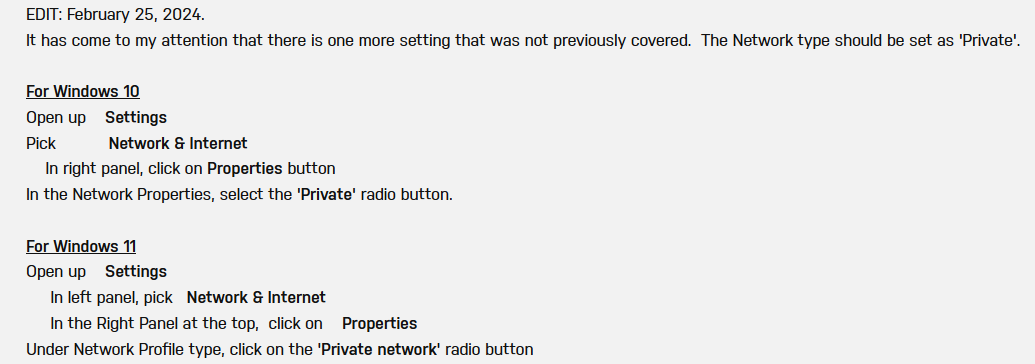

Start here and make sure that the network type is Private:
https://forums.unraid.net/topic/191221-some-musings-on-smb-and-samba-and-unraid-and-windows/#findComment-1561581
If you still have problems let's go on....

11 hours ago, Hoopster said:
This is showing that computer 192.168.1.115 is actually connected to this server. And it currently looking at the 'Pictures' share. (I believe Samba always uses the IP address rather than the server_name. It is the job of the router to resolve the server_name to the IP address.)
From the Pid, it i s actually your Tailscale connection looking at the Pictures share.
Yes, I have Network discovery and File and printer sharing turned on under the Private network. They are off on Public networks. Double checked that yesterday.

I have the same problems in Windows File Explorer. In fact, neither server name or IP address works there.
In my third party File Explorer (Directory Opus), I did pin MEDIANAS (on one of the rare occasions when server name worked) to its Quick Access list. It does not work there either.
Of course, mapping network drives does not work either.

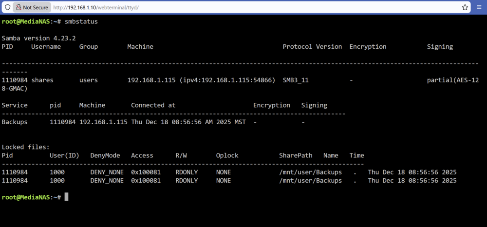

Here is a cleaner smbstatus screen with connection to Unraid via IP address (it survived a reboot) and with the Backups share open in File Explorer. Unraid user name is "shares" so it is connecting via the correct credentials in Credential Manager.
Edited by Hoopster
This looks like everything is normal from a Samba standpoint. You can see the connection from your Windows computer and the user_name is correct.
