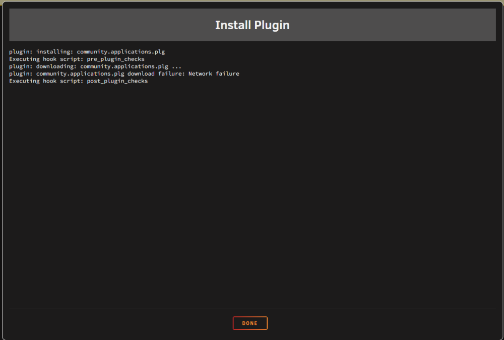

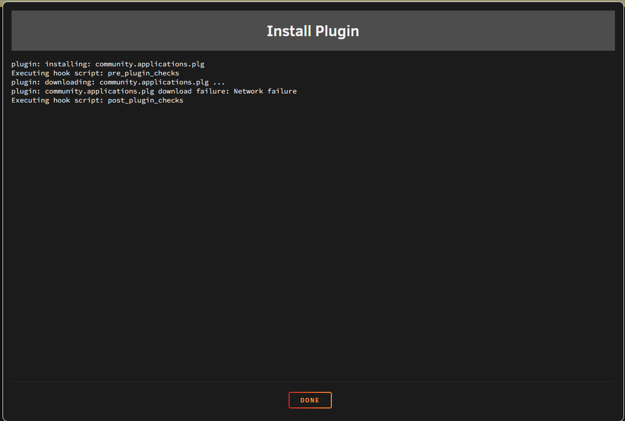

I have this issue i cant fix. it startet with i couldnt open the CA, then i tried to uninstall the CA plugin and now it wont install again.
i have tried to remove the network.cfg and reboot the server no changes.
i have tried to change the DNS to 208.67.222.222 and 208.67.220.220 and 8.8.8.8 and 1.1.1.1
