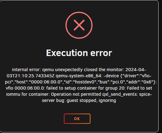

I am trying to setup a win10 VM, and pass through my nvme drive and one of my lan ports too it but i keep getting this error when i try and start the vm too install windows.
I have tried having a good google but i am now out of my depth.

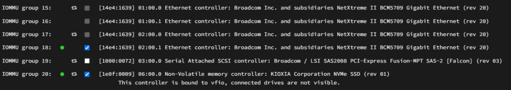

Looks like there may be other devicea in that iommu group you are not passing to the vm. What devs are in grp 18 in system devices
1 minute ago, Knight2339 said:
Do you have a 02 00.0?
i tried it without the lan port and get same error but with the ssd instead group 20

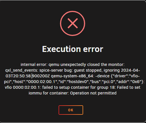

I do its one of the other network ports, ill try adding that as well
Looks like that is in use by the system you may need to look at acs overide settings or post diagnostics
it gave same error but just Group 17 instead
