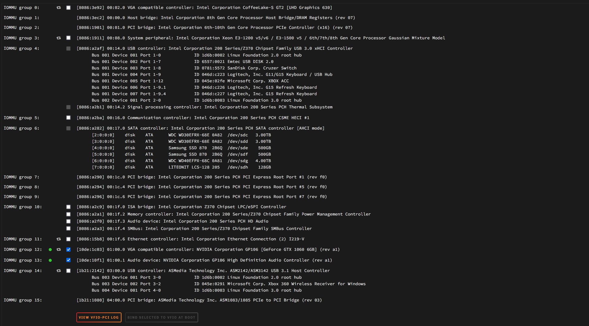

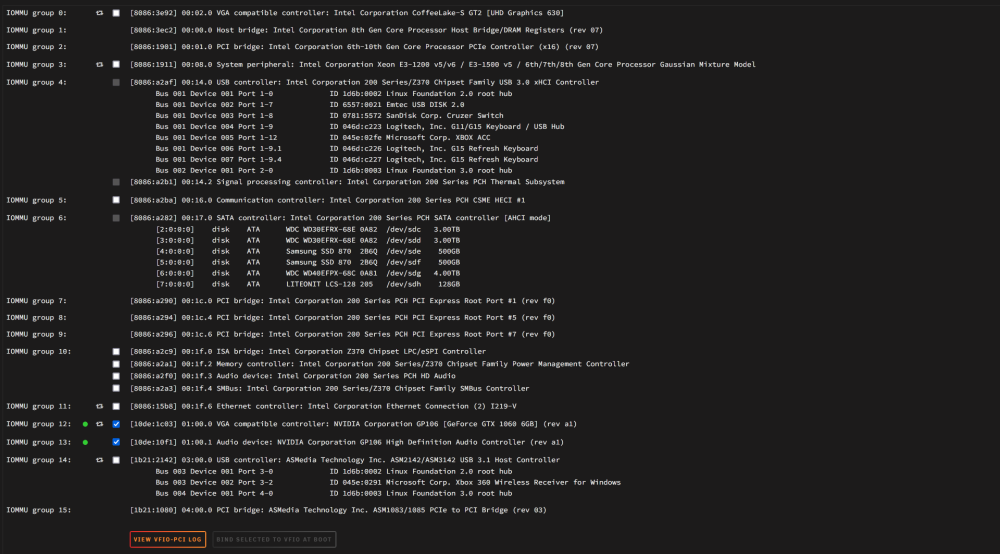

When I try to passthrough my 1060 the VM starts but the monitor I have connected to the GPU shows no signal and one of the CPU's assign to the VM is pinned at 100%.
I have tried looking at most, if not all of space invader ones videos on VM's, looking on forums, other websites, tried the different BIOS and machine types and even different vBIOS for my GPU to no avail. Anyone have a fix?

On 4/2/2024 at 12:26 AM, bmartino1 said:
you will not be able to use the unraid nvdia driver if you have it bound.
the card will need to be bound via iommu to use in a vm properly.
you will need to edit the xml config to fix thr graphic and audio of the g card.
see space invaders video
*this is the secret sauce fix... ^ Thank you Space Invader

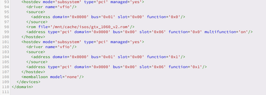

You will need to edit the xml near the bottom and fix your audio to be the next function and to stay on the correct bus.

Fix your xml edits to add mutifunciton to the video portion of the Gcard and fix the bus to match the gcard audio function.

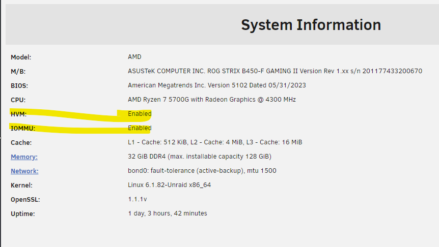

step 1: confirm iommu and hvm:
Dashboard top right info:
next step verify stubed GPU:

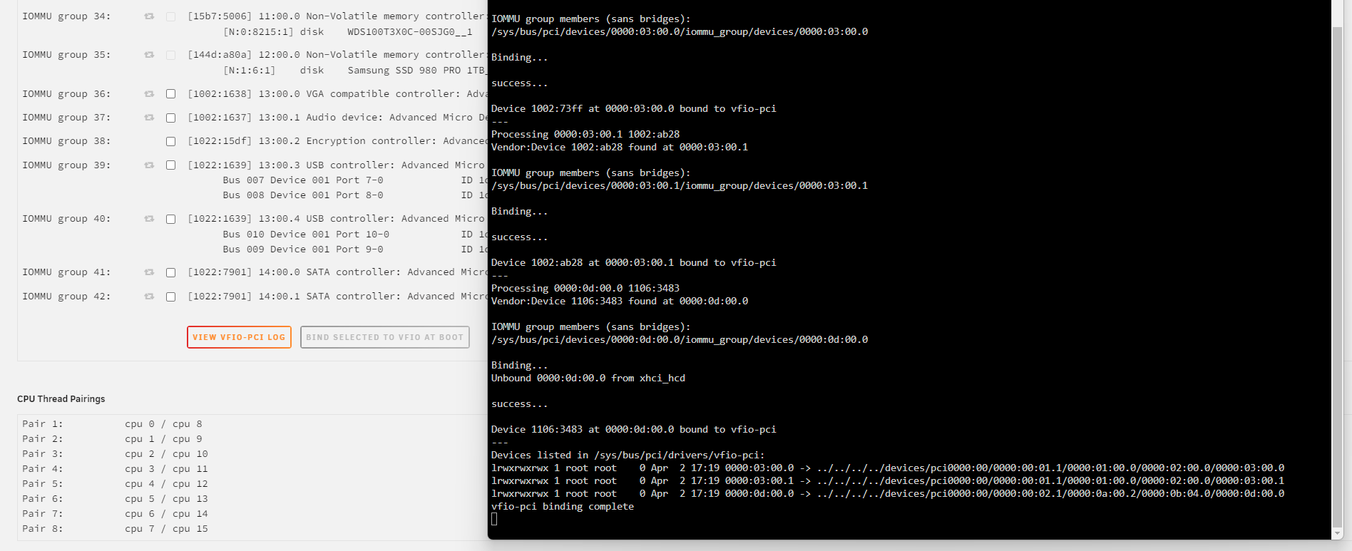

/Tools/SysDevs
Tools > system devices
?iommu slot 1?

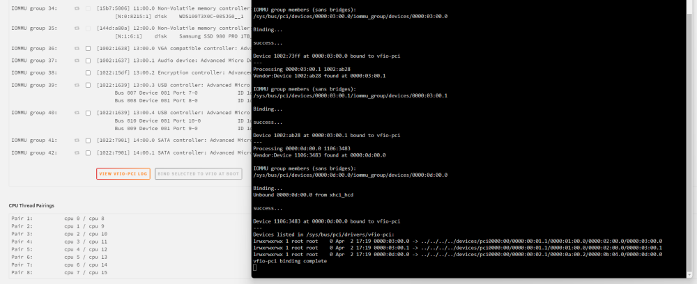

confirm with 2 green dots by gcard and view vfio bind log:

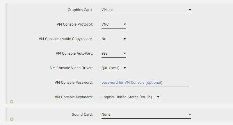

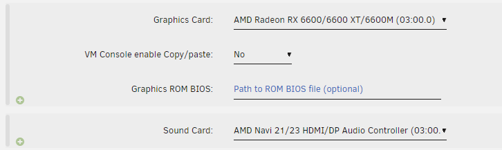

confirm gui settings:
add vm> linux
confirm machine type:
must be q35 (can work with ifx but issues. must be version 7 or above.)
confirm graphic options:
gui must be set before xml edits!
in my case its a amd card.

find keybaord and set proper xml edits.
at end of gcard add mutifunction
next one is audi/hdmi driver.
set to same buss and add function 1...
^this is the bare minimum. other optional are side fixes, enhancements and checks to stop error and ease g-card for transition to use in vm.
