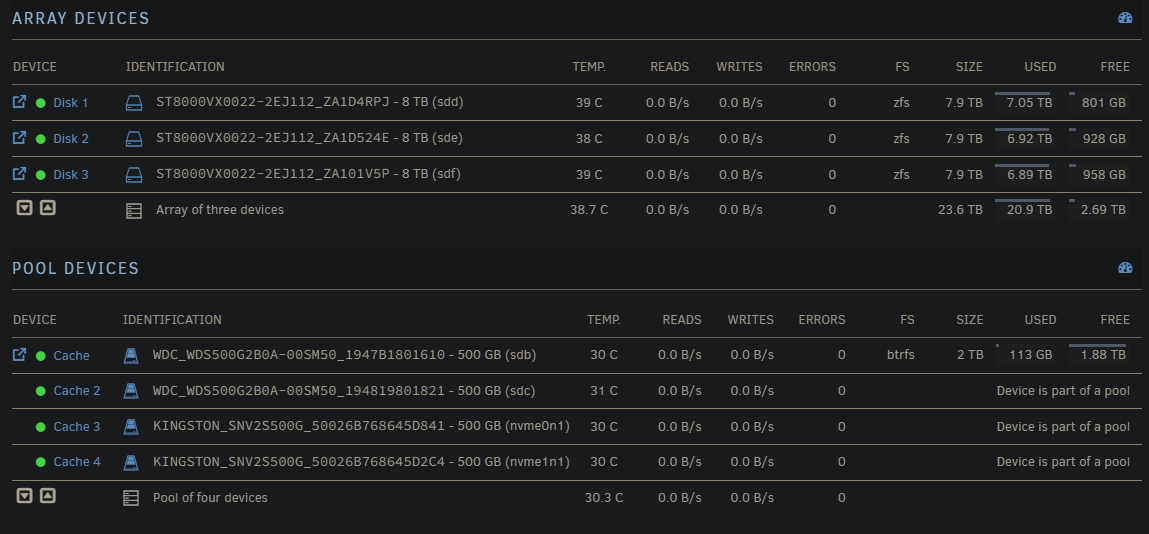

Here's what I'm working with right now:image.thumb.png.34ad8b36e0dc89abd92edbe2f99d8f2f.png
  • 3 x 8TB disks (plus 1 for parity)  ZFS.
  • A cache made up of 4 disks.
Today, I'm getting my hands on 2 x 1TB NVMe and 3 x 16TB disks.
My goal? I want to merge them into an array with 4 x 8TB and 2 x 16TB, throwing in one of those 16TB disks as parity.
But here's the kicker: I'm torn between sticking with ZFS or making the leap to BTRFS. What do you think?
This setup is going to serve as my automated download station, powered by Docker containers, while also handling regular file services, acting as a backup target, AND doubling as a Plex server for 10 users.
Any thoughts or advice would be greatly appreciated!

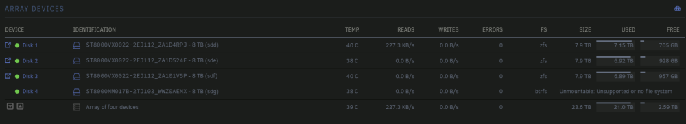

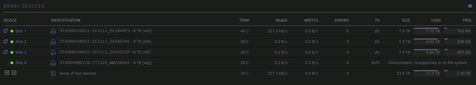

just one last question... i will start now with the movement of the data.
The plan was to move disk by disk, which means I'm currently running unbalanced to transfer all files from disk 1 to disk 4. Once disk 1 is empty, I'll reformat it to BTRFS and repeat this process until all disks are on BTRFS.
Is this the correct approach for migrating like this?
I'm asking because I encountered the message "Unmountable: Unsupported or no file system." This should change once all disks are using BTRFS, correct?
I assume disk4 is new and unformatted? If yes that message will disappear after you format it, with any filesystem.
