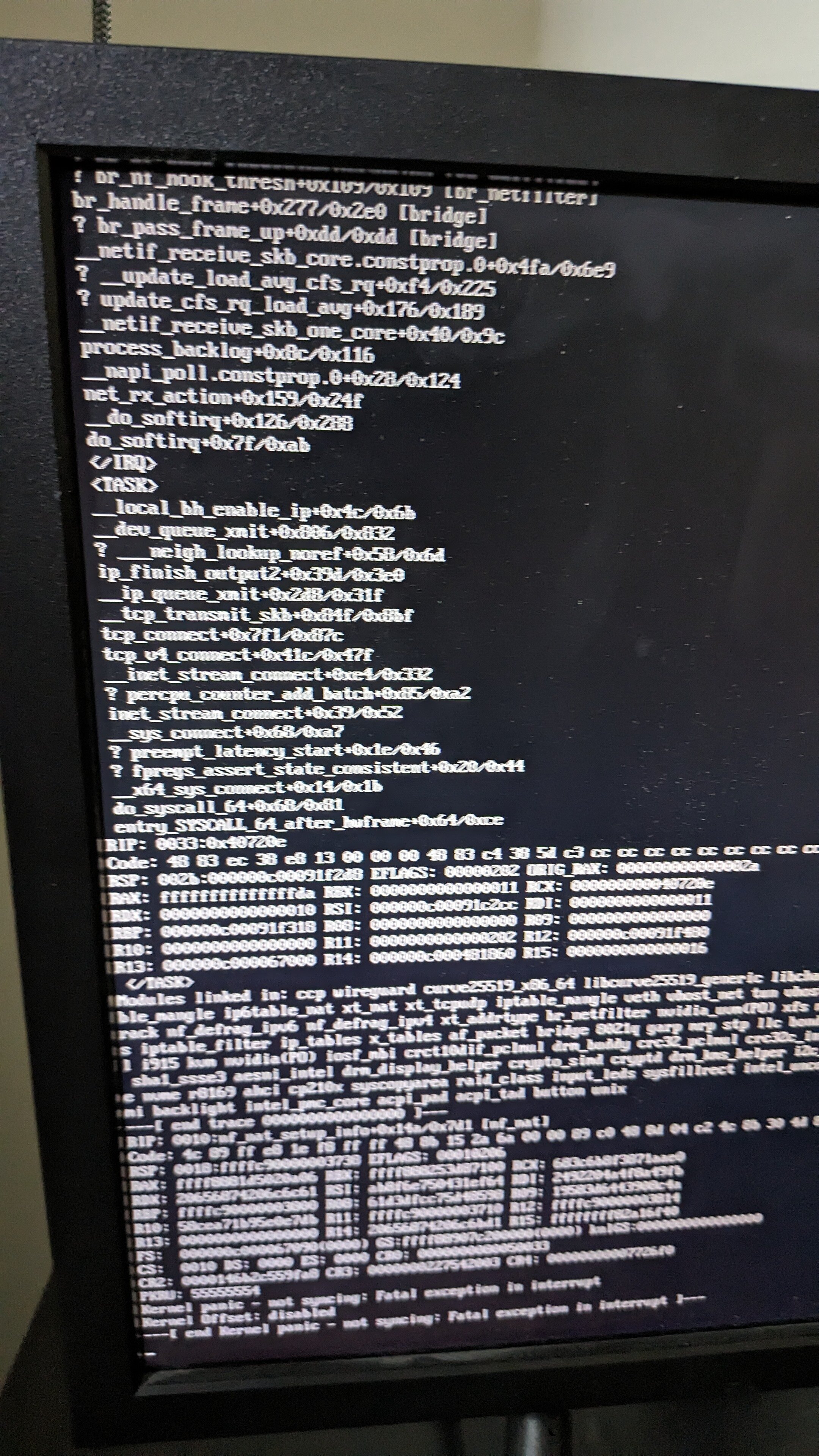

So it has crashed several times but nothing ends up in that log. I hooked up a monitor and took a picture after it crashed. I hope this helps.
That could be macvlan related, try changing docker network to ipvlan and then reboot.
Thanks, I'll give that a shot and see what happens. It's crashing anywhere from 1 day to 7 so it will be a bit but hopefully this dies the truck.
