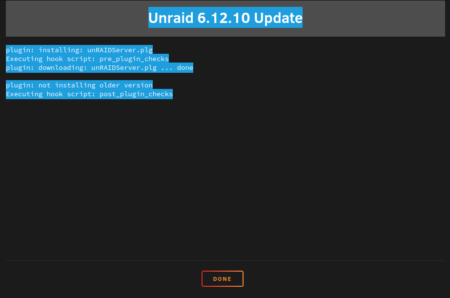

When I try to upgrade, I go through all the steps, but get the following:
Unraid 6.12.10 Update
plugin: installing: unRAIDServer.plg
Executing hook script: pre_plugin_checks
plugin: downloading: unRAIDServer.plg ... done
plugin: not installing older version
Executing hook script: post_plugin_checks
and as seen in the pic below:
Any ideas?
Thanks in advance.:

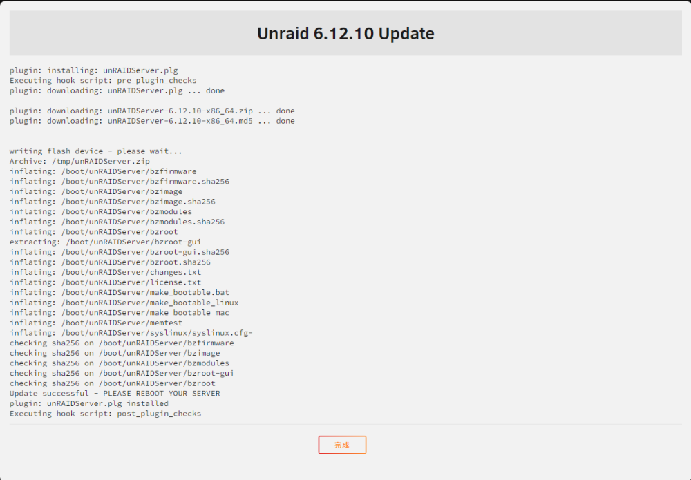

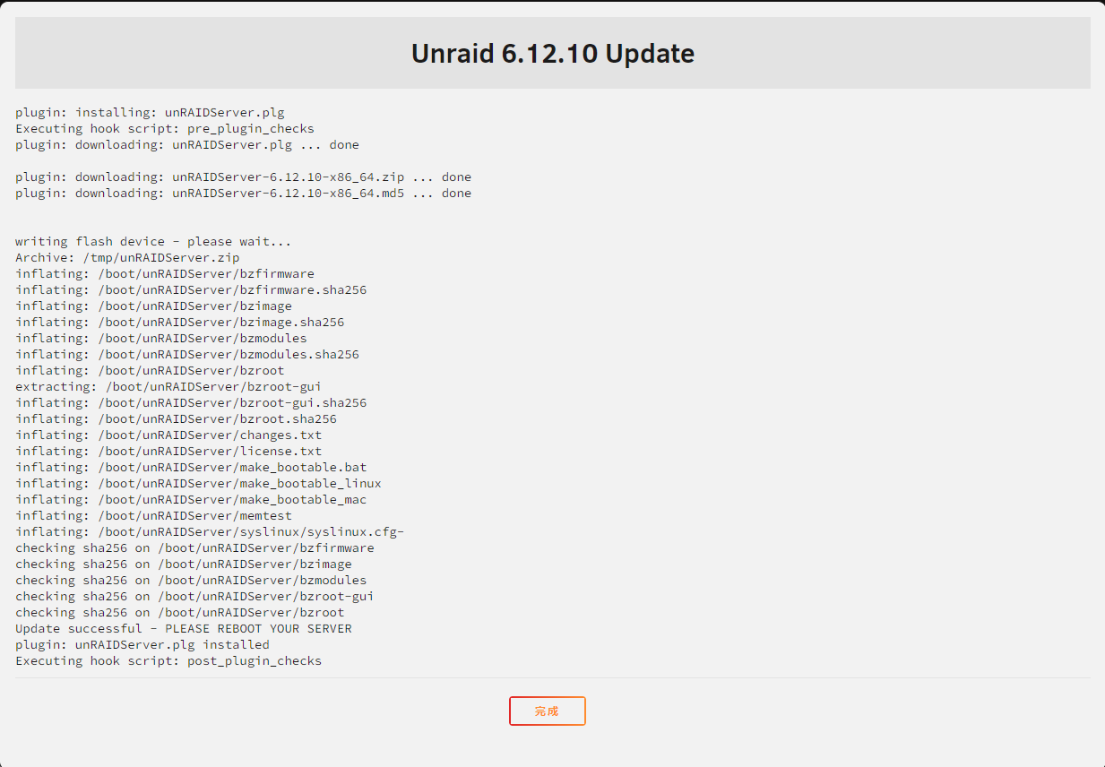

After I updated my plugin,my unraid server can be update to 6.12.10 now(come from 6.12.9)
↓this is my plugin list↓

I had the exact same issue and updating my plugins manually first solved it.
Works for me 2. After i manually updated all Plugins, Update Works
I just had the same issue. Updated the plugins and boom, upgrade working. Weird issue.
