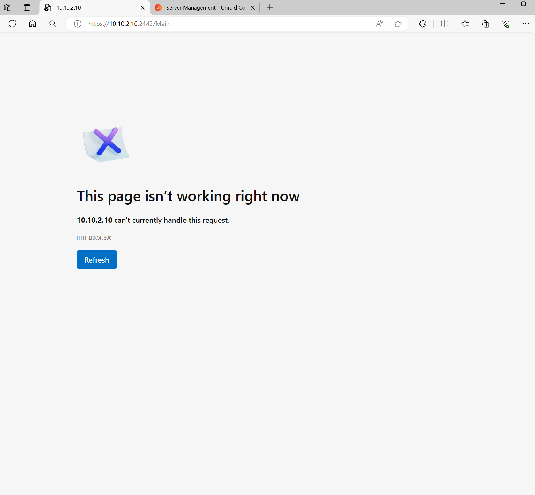

Ive updated to unraid version 6.12.9 from 6.12.8 a few days ago and everything works after update. But today i try to access the webui after i keyin the root and password i got HTTP Error 500.

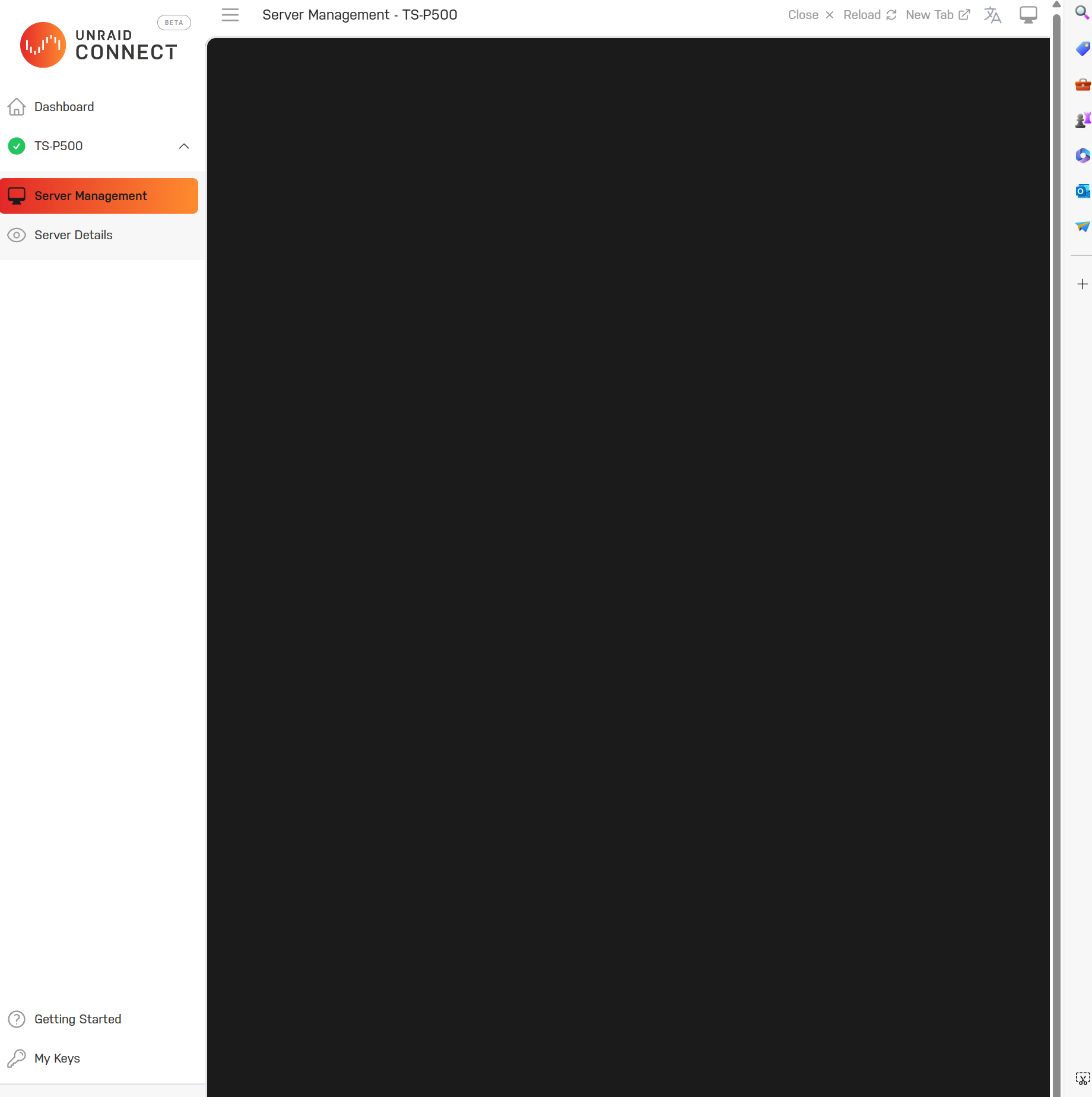

I try to do a Unraid Connect remote also after keyin root and password i got a black screen only.

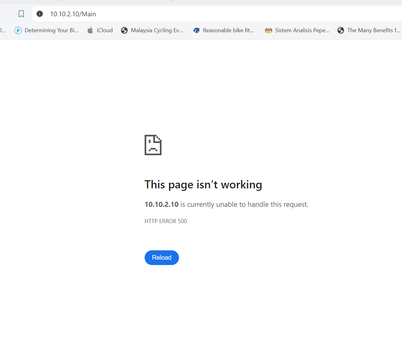

Today the issue happen again after i upgrade to unraid 6.12.13 yesterday.
I still can SSH into the server but my web access gives error HTTP:500
