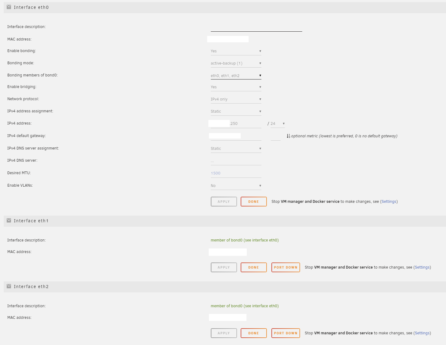

My question for everyone was, is it possible, to set up a 1Gb connection with UnRaid and then have the 10Gb connection there as well but when I plug in the switch for it, anything on the 10Gb network would use that 10Gb connection rather than the 1Gb?   Reason being, the 10Gb switch I have (TP Link 8 port thing) is noisy and personally I'm not a fan so I only really use it when I have mass amounts of data to transfer.  This is generally for backups or trying to move around data on the network.

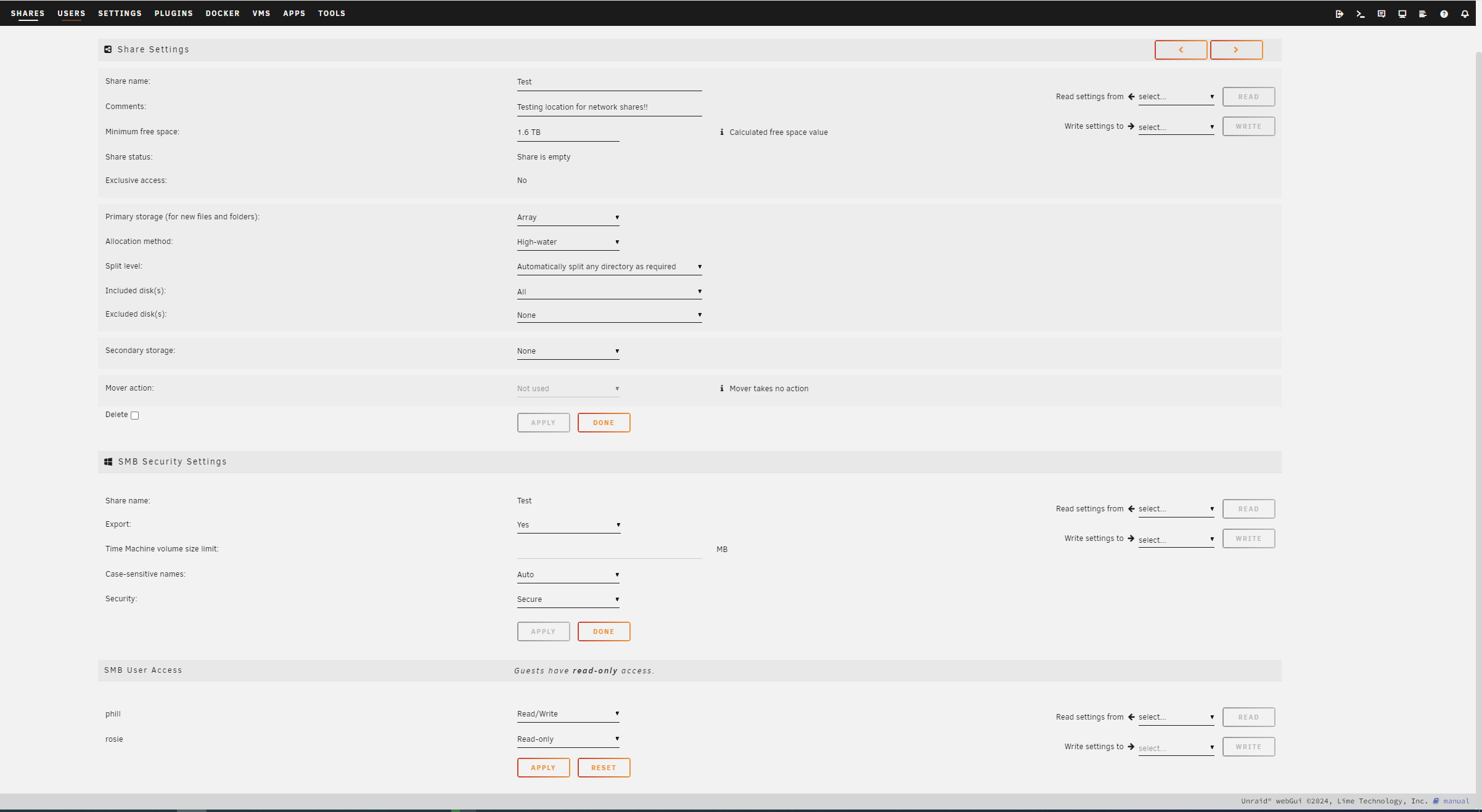

Thirdly, which is hopefully simple and I'm just being a bit dumb; network share access/setup.
With the Synology I was able to setup shares and different users so they had access in to certain folders or it would be read only or they couldn't see it at all.
With UnRaid I have been playing about with that, but not had the greatest of success when trying to set it up.  I noticed when setting up a folder, you have Export in the second part of making the folder and Security - Public, Private and Secure (I believe those are the options)
Would someone be able to confirm for me, that with this test share I've just created, if I have done it correctly please?
You can do it if you connect based on the IP, see here for example:
Thanks for the reply @JorgeB :)
It seems however, everything is bonded together as standard, so I'd presume I'd have to stop the server and then edit the IP and network config to get that part of it up and running?
As mentioned in the video you would use two separates NICs, not a bond.
