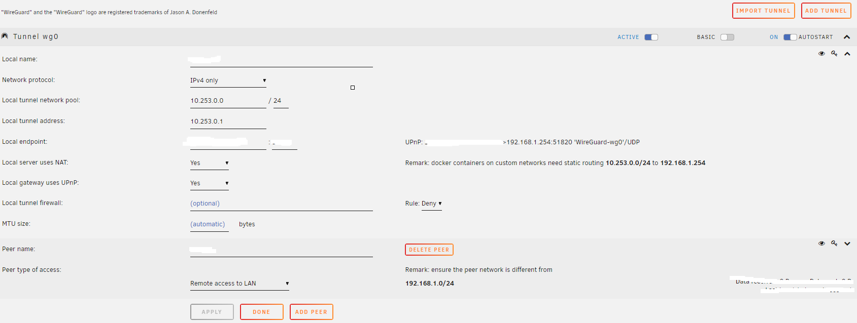

See my Wireguard Setting:
My Unraid is 192.168.2.201
My Docker is e. g. 192.168.2.208
Access to Unraid works fine, no access to docker on 192.168.2.208 with the above config.

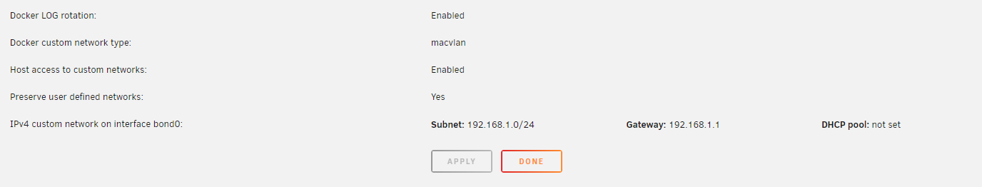

step 3 go to docker settings. and set
Docker custom network type:
macvlan
Host access to custom networks:
Enabled
enable docker and enable vm .
tunnel would also fail if docker doesn't have host access to custom networks.

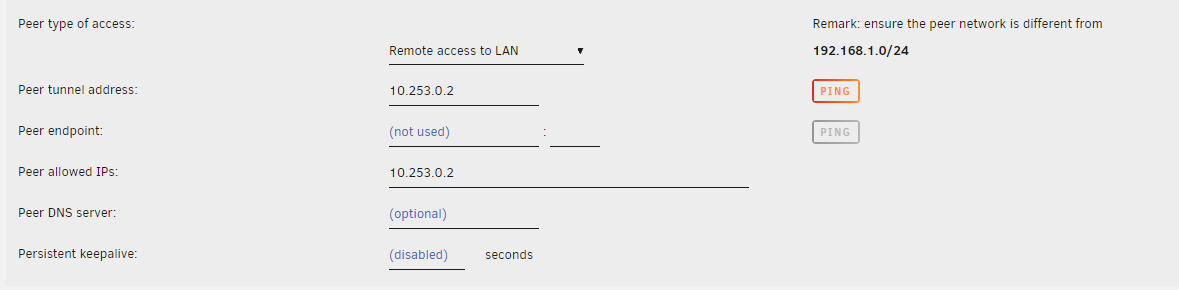

Under the Peer Allowed IPs field you need to put entries for each subnet you want to be able to access via WireGuard.
i think its the docker setting host access preventing this. I agree that adding the ip scheme there should fix this as well. That is not my current setting to allow access and access the ip schema.

Added Host Access to Custom Networks on Docker
Added Route from 192.168.2.201 to 192.168.2.208
Docker Setting:
Example Docker:

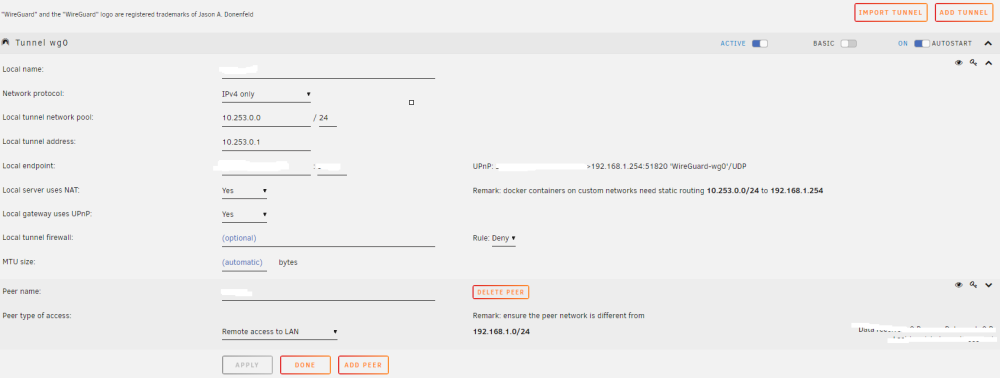

WireGuard
Result same for me: Access to 192.168.2.201 works, 192.168.2.208 does not.

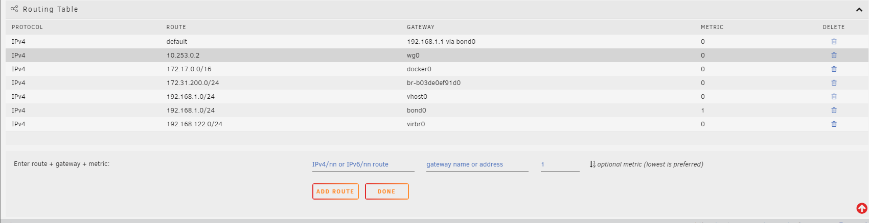

Can you access any other 2.x address such as your router over the tunnel? if yes its your docker 2.208 settings. if no its network/routing issue.
Other than the bad route data. as metric should be 1 but that line ipv4 192.168.2.208 wg0 is not a good data rout. that's telling unraid that ip goes to interface wg0 no traffic would be making it across.
I belie you should disable bridging. this may be causing a macvlan trace issue.
Otherwise, set docker setting to ipvlan.

As far as i can tell ipv4 192.168.2.208 wg0 gets added automatically, if i add 192.168.2.208 as allowed peer IPs under Wireguard VPN Manager.
• Removed 192.168.2.208 from allowed peers under VPN
• Disabled Bridging
The Disabling of Bridging did it i think, access to all Dockers works now as well as other network devices and router.
