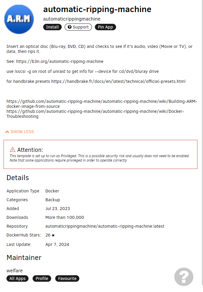

I installed automatic-ripping-machine using Unraid app automatic-ripping-machine. I only change the nvidia setting for my nvidia gpu.
I can't connect to the web interface. The log show sql database errors, along with a number errors. How can I down load my logs to show you my complete error list.

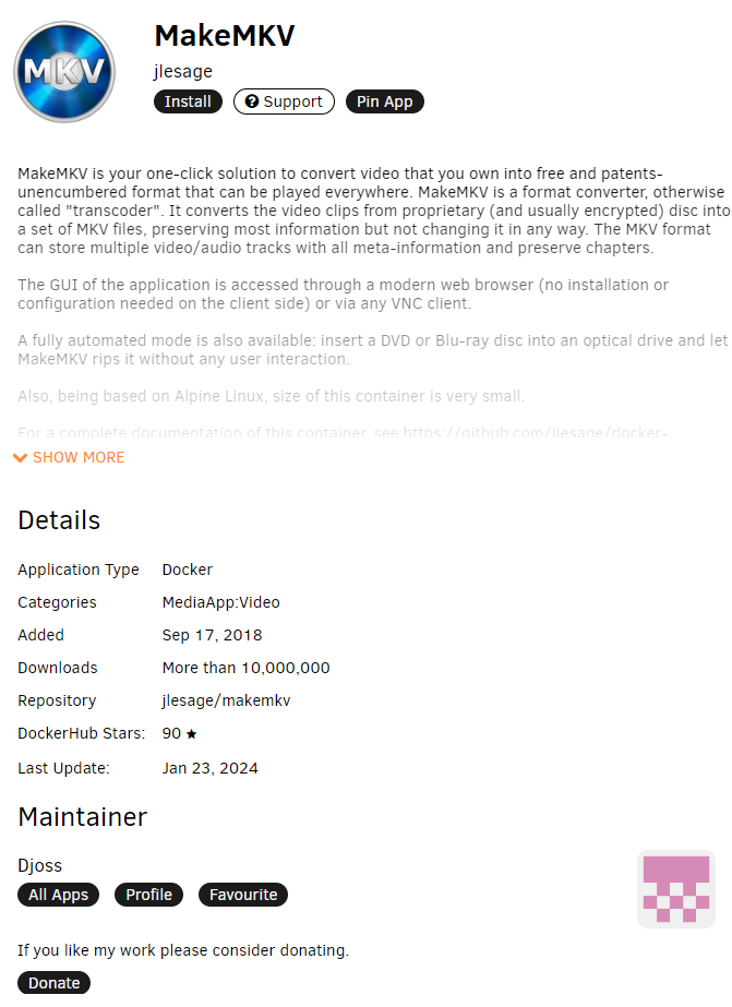

I use makemkv (with a purchased key as to use windows/linux if needed outside the docker.)
you can use the free public beta keys
https://forum.makemkv.com/forum/viewtopic.php?t=1053

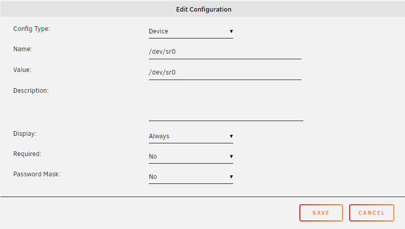

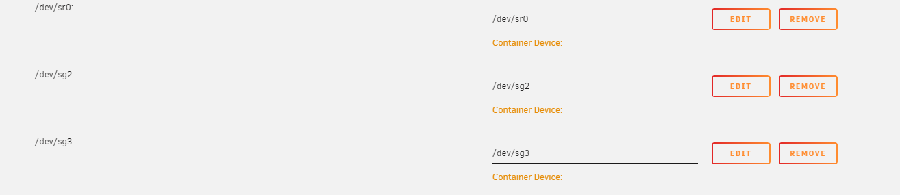

**NOTE**: For the container to have access to your optical drive(s), you need to add them to your container configuration.  This is done by adding a new "Device".  An optical drive is represented by two Linux device files: "/dev/srX" and "/dev/sgY".  For optimal performance, the container needs both of them.  To determine the right devices to use, start the container and look at its log.
i have 2 disk drives to rip disk data form so i added:

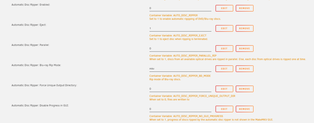

Using this docker I can rip my purchased physical media automatically to a folder for my plex docker to parse and added to library.

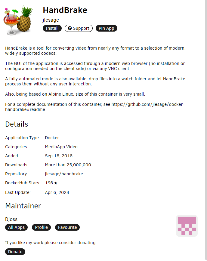

I'm not familiar with the automatic docker. this appears to be using handbreak to rip
and would recommend asking a question on the support docker form for support issues.
Otherwise, I would recommend using the handbrake docker.

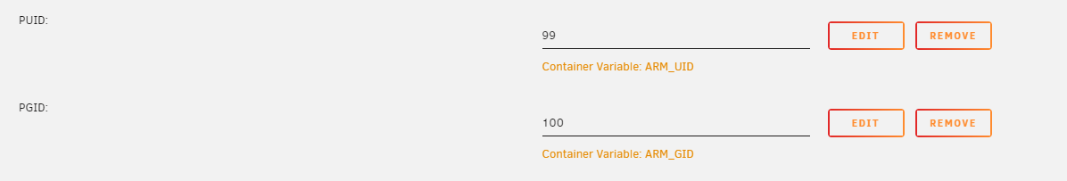

After I change the PUID to 0 and PGID  to 00, I'm stll unable to access the web interface. My logs is show these error.

the puid is advance user settings file access by id #. and should be 99 for unraid root user.
That is something you should not be changing in the template...
you may need to delete the docker and data, delete the appdata folder and reinstall the docker...
