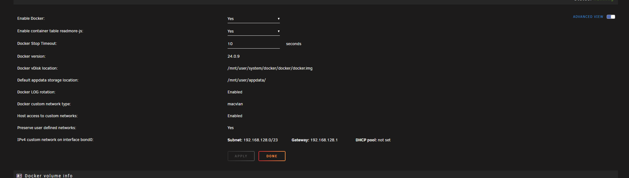

1. what network/docker network are you running
-By default unraid enables bridge mode and doesn't set docker correctly(macvlan).
*Either disable bridge mode or set docker network type to ipvlan
2. Under docker setting is host access to network enabled.
-enable this.

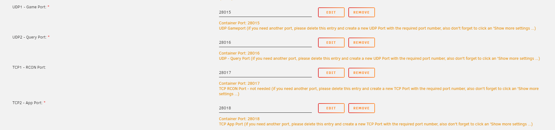

When using the docker system ports are done via the template / environment variables.
as seen here in this template
This creates the docker run command in docker, this pass the variable -p ####:#### for ports exposure to use the service inside the docker.

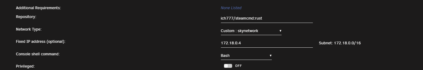

i try to do it step by step now im getting a rcon connection but i still cant join

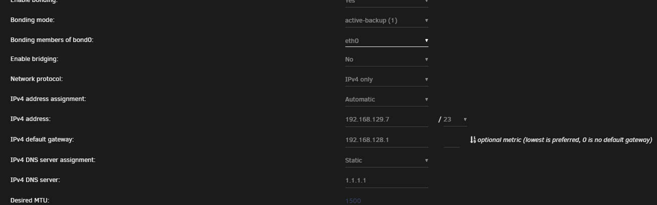

You are using a docker custom network that you may have created. You need to use unraids custom network and use a ip in your routers DHCP scheme.
in the container rust. the docker network type should be connecting to custom eth0
and be assigned a similar ip of 192.168.129.x
