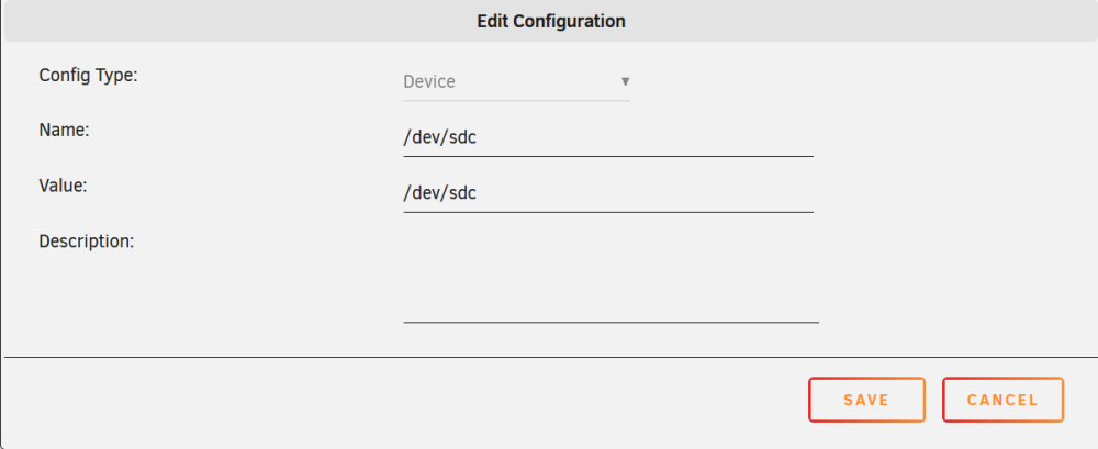

320566135-8f445a95-2fd6-46c7-808d-3ac572068138.png.3309bed69d759e0d5b4e3d1b939ed9b8.png
In my Docker settings it looks like this.

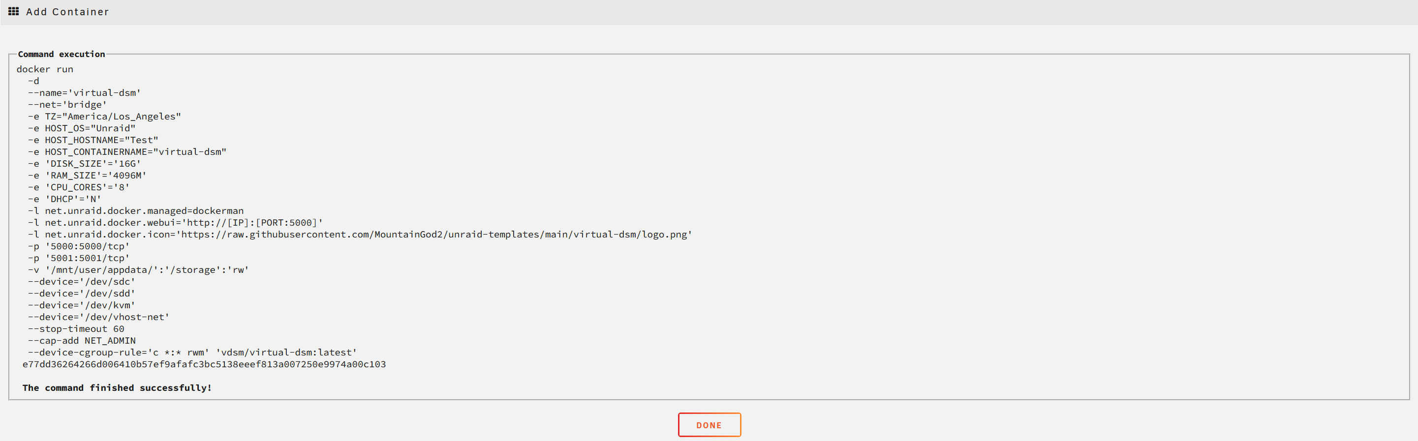

320566649-f0b936fc-d66b-4394-bdaa-cc7187456eb1.png.e18a9ce735aa5feacf366ff4f59b2695.png

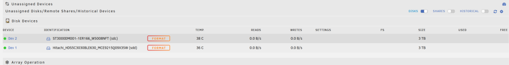

And with the HDDs like this
320567345-c0d35244-63b4-4427-b286-cdf251436e4a.png.3766828e6010ac5edd48f6edd26ab9fa.png

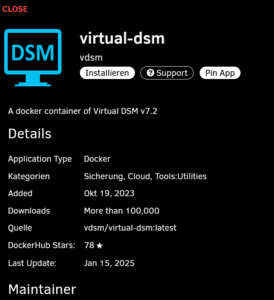

After the installation
320584901-f93bb472-3a3c-4b32-8ea2-626512c838e5.thumb.png.8b5bccd45527c92cf75012f2cbff1b23.png

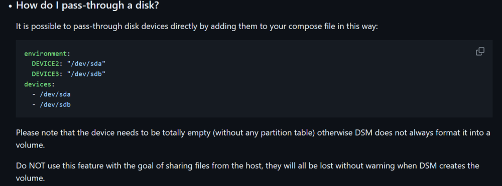

How do I pass-through a disk?
It is possible to pass-through a disk device directly, by adding it to your compose file in this way:
devices: - /dev/disk/by-uuid/12345-12345-12345-12345-12345:/disk2
Make sure to bind the disk via its UUID (obtainable via lsblk -o name,uuid) instead of its name (/dev/sdc), to prevent ever binding the wrong disk when the drive letters happen to change.

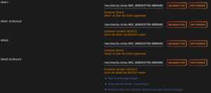

this for vDSM
you have to add 2 entries for each disk:
First add a "disk" and point it to your ID ( ls /dev/disk/by-id -las )
Second add a "variable" and call it DEVICE2 <-- or other number
past the same ID as in first entry "disk"
ENJOY :)
