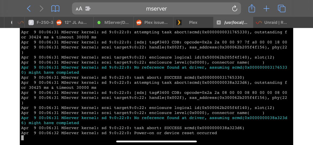

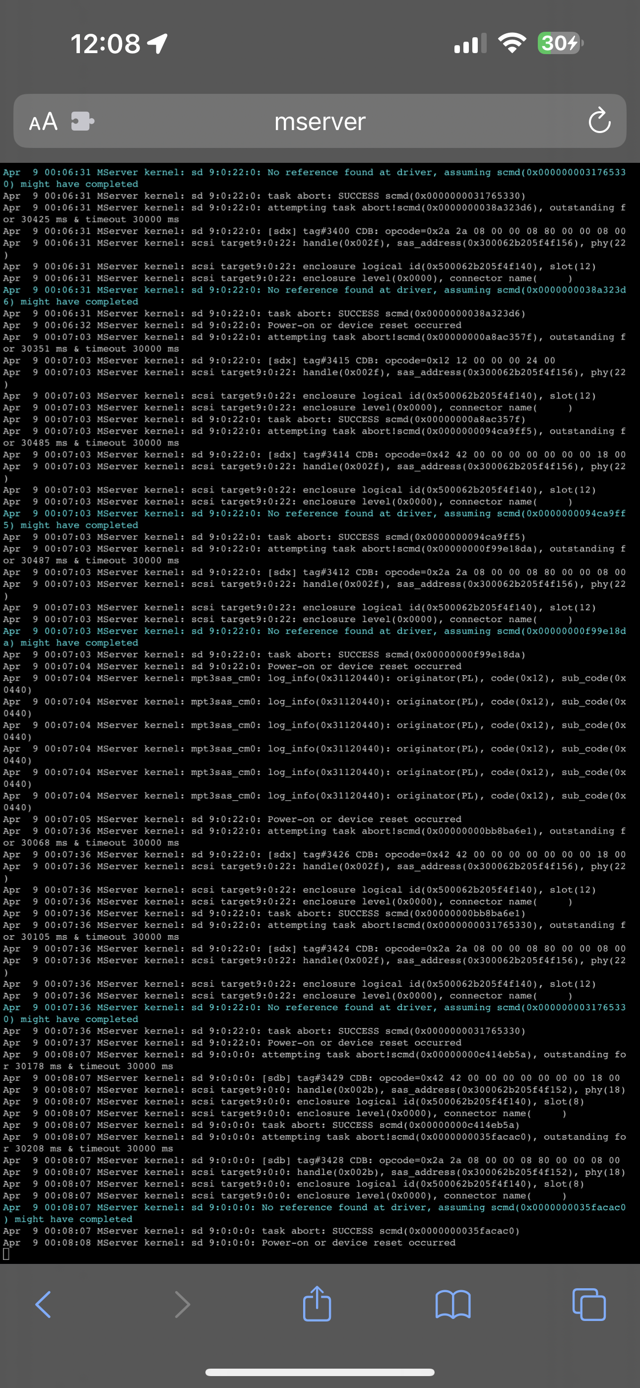

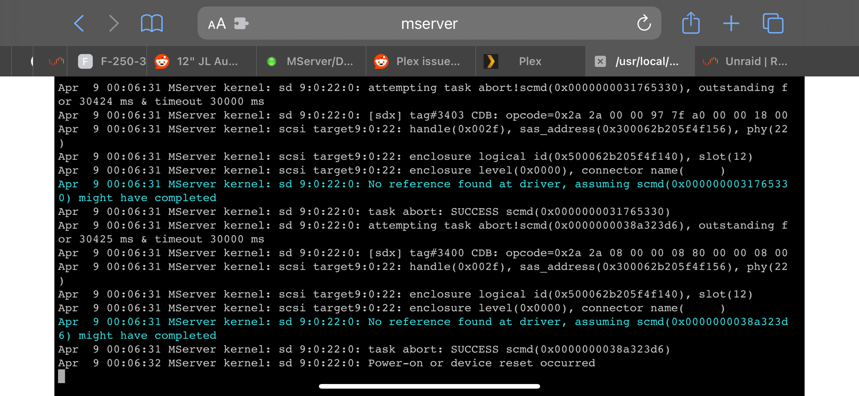

1: I attached a couple images of what looks like a repeated issue for a driver???? Not sure how to handle that.

I have one on boot:
Apr  9 22:27:13 MServer kernel: ACPI BIOS Error (bug): Failure creating named object [\_SB.PC00.PEG1.PEGP._DSM.USRG], AE_ALREADY_EXISTS (20220331/dsfield-184)
Apr  9 22:27:13 MServer kernel: ACPI Error: AE_ALREADY_EXISTS, CreateBufferField failure (20220331/dswload2-477)
Apr  9 22:27:13 MServer kernel: ACPI Error: Aborting method \_SB.PC00.PEG1.PEGP._DSM due to previous error (AE_ALREADY_EXISTS) (20220331/psparse-529)
Error that still repeats in the log:
Apr  9 22:32:43 MServer kernel: sd 1:0:0:0: device reset: FAILED scmd(0x000000003c043558)
Apr  9 22:32:43 MServer kernel: scsi target1:0:0: attempting target reset! scmd(0x000000003c043558)
Apr  9 22:32:43 MServer kernel: sd 1:0:0:0: [sdb] tag#1928 CDB: opcode=0x2a 2a 08 00 00 08 80 00 00 08 00
Apr  9 22:32:43 MServer kernel: scsi target1:0:0: handle(0x002b), sas_address(0x300062b205f4f152), phy(18)
Apr  9 22:32:43 MServer kernel: scsi target1:0:0: enclosure logical id(0x500062b205f4f140), slot(8)
Apr  9 22:32:43 MServer kernel: scsi target1:0:0: enclosure level(0x0000), connector name(     )
Apr  9 22:32:43 MServer kernel: scsi target1:0:0: target reset: SUCCESS scmd(0x000000003c043558)
Apr  9 22:32:44 MServer kernel: sd 1:0:0:0: Power-on or device reset occurred
Apr  9 22:32:51 MServer kernel: sd 1:0:0:0: attempting task abort!scmd(0x0000000062bae2ce), outstanding for 7045 ms & timeout 7000 ms
Apr  9 22:32:51 MServer kernel: sd 1:0:0:0: [sdb] tag#2020 CDB: opcode=0x12 12 00 00 00 fe 00
Apr  9 22:32:51 MServer kernel: scsi target1:0:0: handle(0x002b), sas_address(0x300062b205f4f152), phy(18)
Apr  9 22:32:51 MServer kernel: scsi target1:0:0: enclosure logical id(0x500062b205f4f140), slot(8)
Apr  9 22:32:51 MServer kernel: scsi target1:0:0: enclosure level(0x0000), connector name(     )
Apr  9 22:32:51 MServer kernel: sd 1:0:0:0: task abort: SUCCESS scmd(0x0000000062bae2ce)
Apr  9 22:32:52 MServer kernel: sd 1:0:0:0: Power-on or device reset occurred
Apr  9 22:33:27 MServer kernel: sd 1:0:0:0: attempting task abort!scmd(0x00000000b9e4230c), outstanding for 30360 ms & timeout 30000 ms
Apr  9 22:33:27 MServer kernel: sd 1:0:0:0: [sdb] tag#1876 CDB: opcode=0x42 42 00 00 00 00 00 00 00 18 00
Apr  9 22:33:27 MServer kernel: scsi target1:0:0: handle(0x002b), sas_address(0x300062b205f4f152), phy(18)
Apr  9 22:33:27 MServer kernel: scsi target1:0:0: enclosure logical id(0x500062b205f4f140), slot(8)
Apr  9 22:33:27 MServer kernel: scsi target1:0:0: enclosure level(0x0000), connector name(     )
Apr  9 22:33:27 MServer kernel: sd 1:0:0:0: task abort: SUCCESS scmd(0x00000000b9e4230c)
Apr  9 22:33:27 MServer kernel: sd 1:0:0:0: attempting task abort!scmd(0x00000000cbf14f21), outstanding for 30391 ms & timeout 30000 ms
Apr  9 22:33:27 MServer kernel: sd 1:0:0:0: [sdb] tag#1875 CDB: opcode=0x2a 2a 08 00 00 08 80 00 00 08 00
Apr  9 22:33:27 MServer kernel: sd 1:0:0:0: No reference found at driver, assuming scmd(0x00000000cbf14f21) might have completed
Apr  9 22:33:27 MServer kernel: sd 1:0:0:0: task abort: SUCCESS scmd(0x00000000cbf14f21)
These are usually harmless and BIOS related.
Would recommend replacing the SATA cable or connecting this SSD to the onboard SATA
So Drive SDB is a SSD in raid 1 for my app data cache.
There would be 4 devices on that cable and backplane,
LSI 9305 24i so 6 cables one to each backplane. Each backplane is 4 drives.
Drive SDX is the mirror to the drive above. (SDB)
