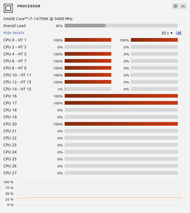

The system hasn't crashed yet, but it is behaving very strangely. Some examples include:
  1. Jobs in docker containers are frozen.
  2. I cannot kill these docker containers either via web gui or shell
    1. Via gui: popup window after pressing 'stop'
      "Execution error
      Server error"
    2. Via shell:
      $ docker kill <conainer_name>
      Error response from daemon: Cannot kill container: <container_name>: tried to kill container, but did not receive an exit event
  3. Can't start or stop the docker daemon via the settings screen
    1. Settings gui will show it's stopped, but when I `docker ps` all the containers are still running
  4. System doesn't respond to reboot requests, either via web gui or shell
  5. Can't take the array offline, the button doesn't respond in any way
  6. There are tons of CPUs that are stuck in a waiting state
Additionally, there are quite a few stack traces here as well such as:
Unable to access opcode bytes at 0xffffffffffffffd6.
Maybe the issues documented under ram stick 2 aren't actually related to a bad ram stick, but it is what I have experience while trying to test the second ram stick.
My plan is to continue to test ram stick 2 to see if it eventually does crash, but thought these issues were weird enough to note during the debugging process.
