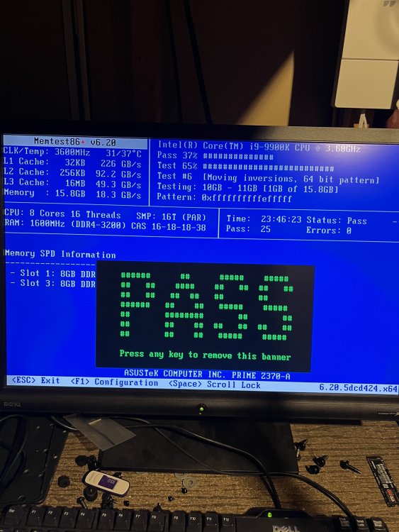

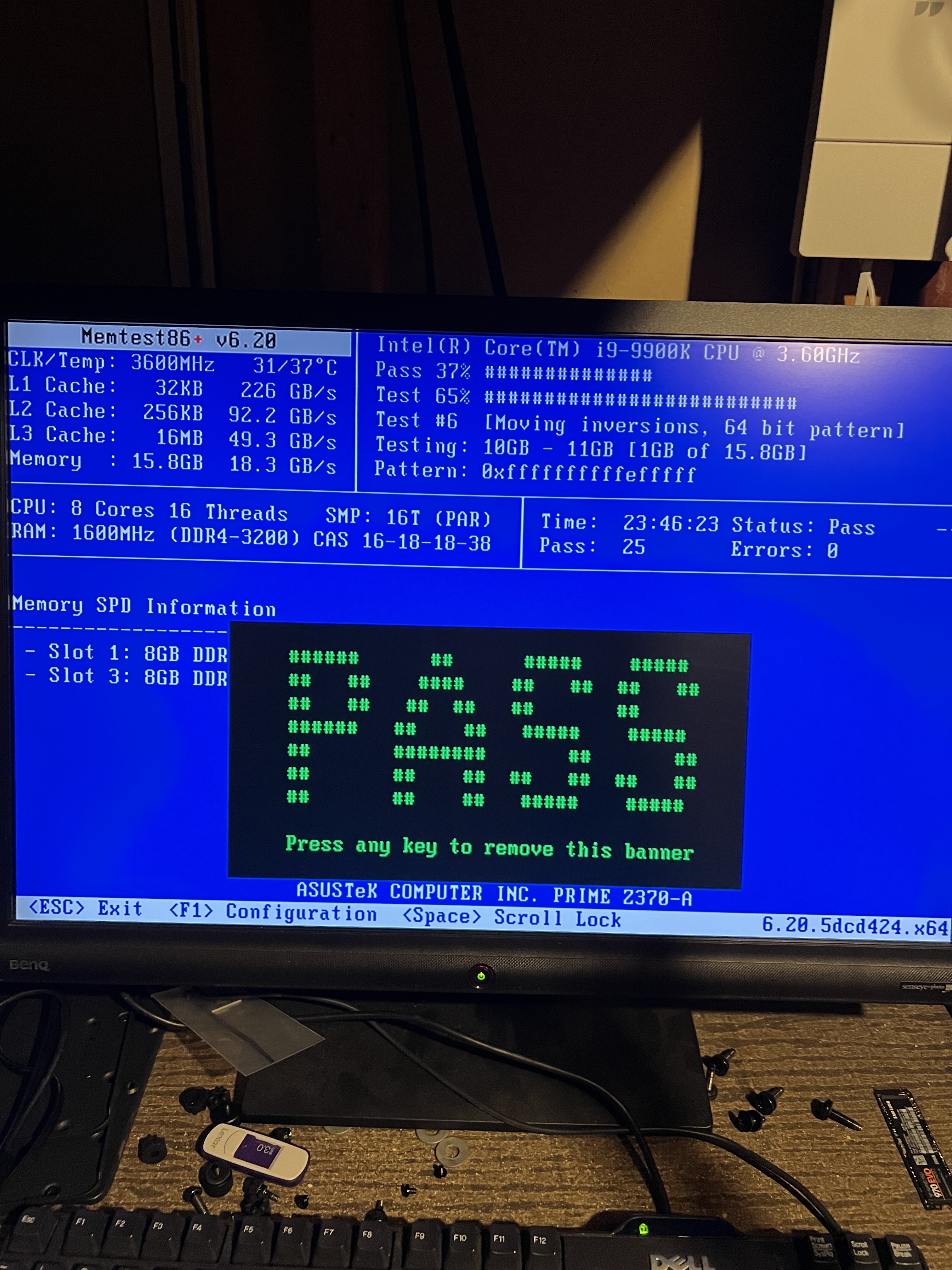

April 19, 20242 yr Community Expert 41 minutes ago, jedimastergrant said: Could this be an issue? Possibly, could still be a RAM issue since memtest is only definitive if it finds errors, since you have multiple sticks try with just one, if the same try with a different one, that will basically rule out bad RAM.
