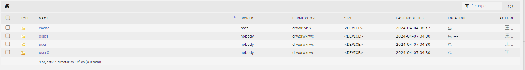

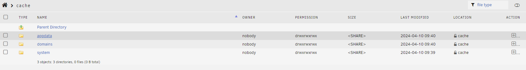

April 10, 20242 yr Hello guys, I am seeing some errors on the Unraid. IntelNuc emhttpd: *** bug: 57 /mnt/user/system cache IntelNuc emhttpd: *** bug: 57 /mnt/user/domains cache IntelNuc emhttpd: *** bug: 57 /mnt/user/appdata cache I checked the parity of the disks . I created folder "cache" on all 3 locations, but the issue is still there. Please help. Best Regards, Radu

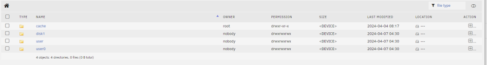

April 10, 20242 yr Author i saw something strange...the folder cache has owner "root" and the folders inside have owner "nobody"....should that be a problem? i changed the cache folder to owner "nobody", same issue..... Edited April 10, 20242 yr by radu.teo
