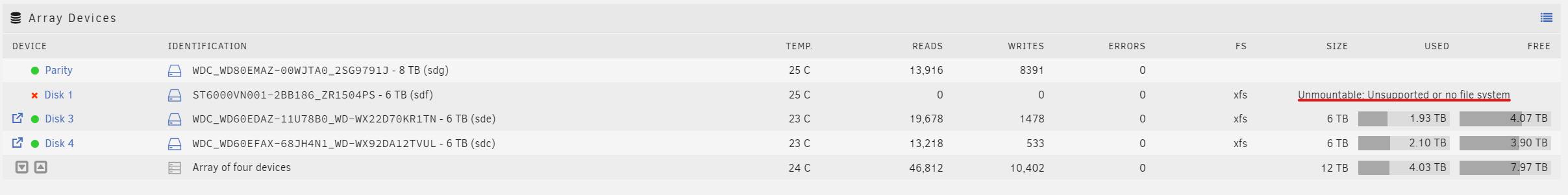

Unmountable: Unsupported ore no file system
As you can see in the picture, there is a disk that has come off.
The disk that has died will be replaced with a 4TB Sata SSD, but to be able to do that, I have to make a "New Config"?
Does this mean that the data on disk 1, which for some reason is not emulated, cannot be recreated?
A little extra info: There are 18 usable TB. Approx. 2 TB on each disk was used, 6 TB in total.
Hope some of you can help.

You cannot replace a 6TB disk with a 4TB SSD, for now please post the diagnostics.

The 4 TB SSD's is my only option, the 8 TB SSD's are too exspensive. I am not buying more spinning metal they die after a couple of months og use, Both Seagate and WD.
I have a hardtime understanding that document.
I know i will lose all the data on Disk1 with New Config, but that is my only option at this point.
Check filesystem on disk1, run it without -n, and if it asks for -L use it.
It the repair is successful you can then move the data to another disk(s) and do a new config with the 4TB SSD.

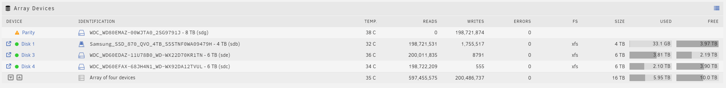

Made a new config with the SSD and parity is being build.

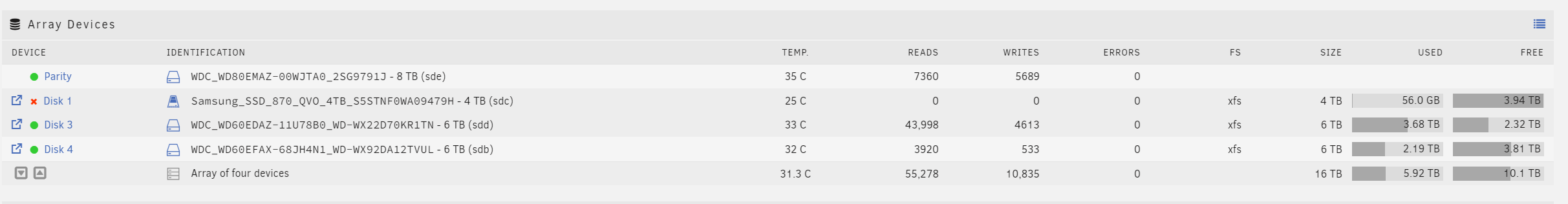

I mountet the new SSD, but have problem already. Disk is disabled.
tower-diagnostics-20240413-1853.zip
Diags are after rebooting so we can't see what happened, but most likely a power/connection issue.

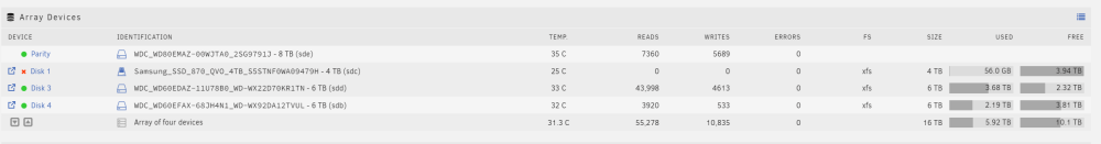

tower-diagnostics-20240414-1144.zip
Those also are after rebooting.
Yes
