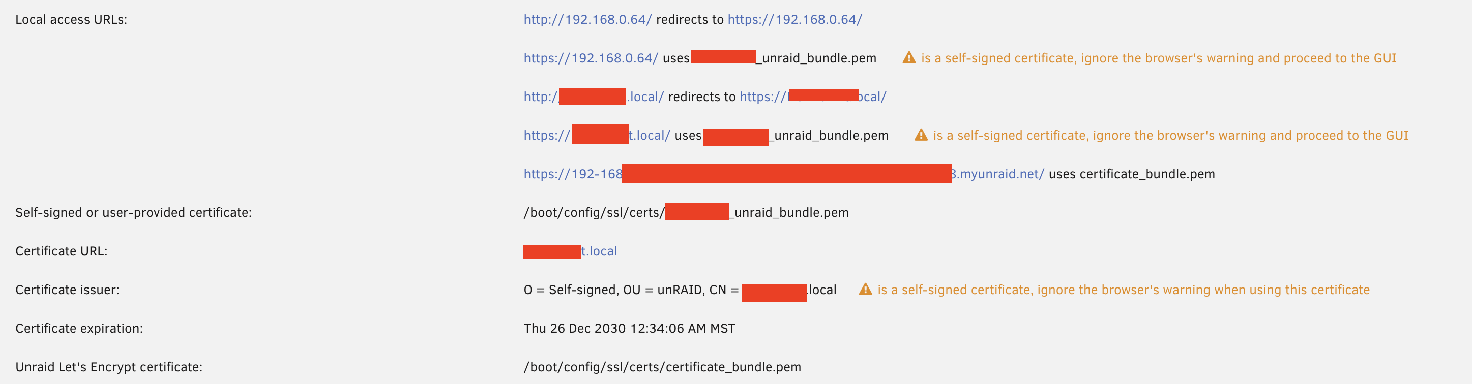

I have provisioned an Unraid LE certificate and Unraid Connect is working as is the "*.myunraid.net" URL. However when looking at the Management Access settings I see the following:618441712_Screenshot2024-04-12at17_27_54.thumb.png.eaf7fe7ff6606cd1a756e983398150b1.png
It looks like the "*.myunraid.net" is using certificate_bundle.pem while the local URLs are all using the SERVER_unraid_bundle.pem certificate, this is causing me to get an SSL warning when I navigate to my Unraid GUI.
This is correct.  The certificate_bundle.pem cert is ONLY valid for *.myunraid.net urls. There is zero benefit to using it with other urls.  If you access the server by IP address or by name then it will use a self-signed cert.
But there are no instructions on setting that up.
It is fully setup. To use it, click the url starting with https://192-168... that you blanked out of the screenshot.
For more information, see https://docs.unraid.net/unraid-os/manual/security/secure-webgui-ssl/
