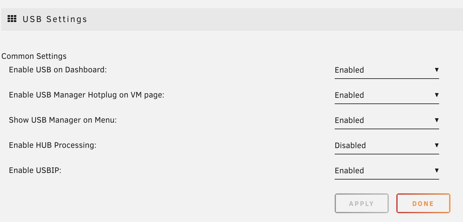

I tried to install the plugin, but not sure it is working. In the plugin settings, it says "status: stopped". All settings are enabled except "hub processing".

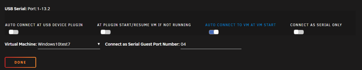

Click on USB in the menu bar and you will get the setup page. Click on the line next to the mouse and click on the usb icon to map the port or screen for a device.
Then in the settings page specify the VM name, Auto connect at VM start.
Auto connect at USB device plugin will connect it to the VM if you unplug and then plugin if the VM is running.

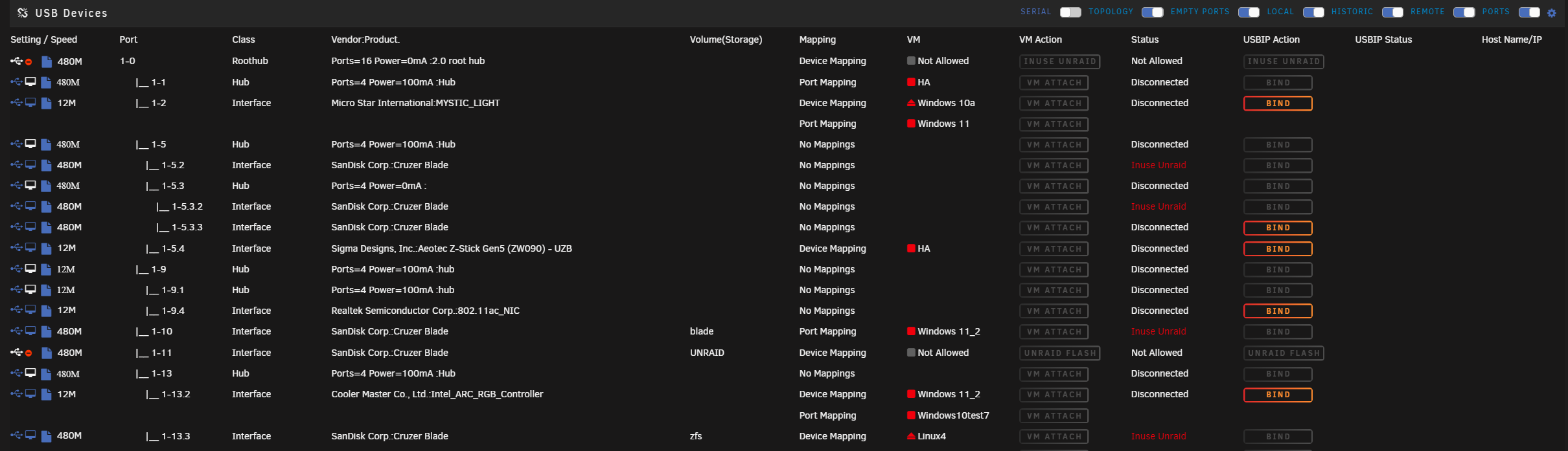

Not sure I am seeing what I mean to see. I went to the setup and see below info:
Click on usb on here : image.png press F5 if you dont see it.
