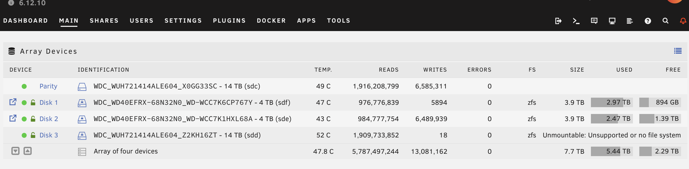

Hi, ~20 hours ago power disconnected from my unraid machine. When booting up again, as expected, the system started a parity check, which is still running. I was not particularly concerned with data validity as most of the times my disks are spun down, and only the cache is being written.
Though, I just noticed something pretty bad: all the files created in the past 8 months or so, seem to be lost, unless for some miracle they will reappear when the parity check ends. This behavior is different from anything I've experienced in the past.
Another thing I'm noticing is that one of the disk is showing "no file system" and is not being mounted. But, on the other hand, that disk seem to be being used for rebuilding parity, thus also wiping my chance of getting my data back through that.

this is after starting the array in maintenance mode. With the array stopped, only cache entry is shown.

That's because you are using encryption, start the array in normal mode, post new diags and that output again.
with the array started in normal mode (non maintenance):
