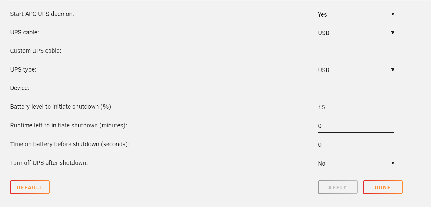

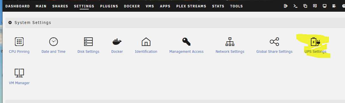

Unraid supports apcupsd (look in Settings) natively as well as a NUT UPS plugin.

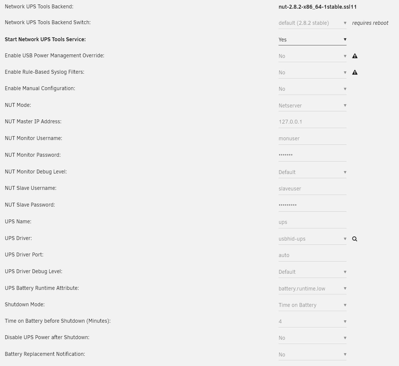

I am using a Cyberpower UPS with unraid via USB connection.
Model = CP1500EPFCLCDa

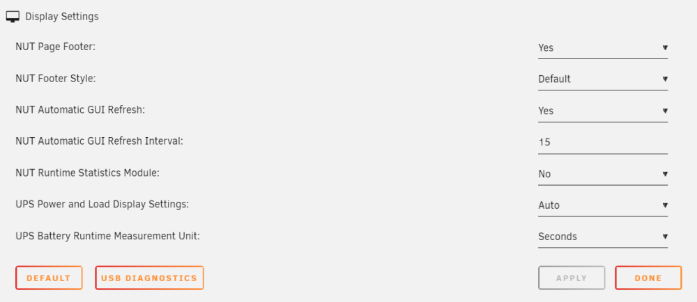

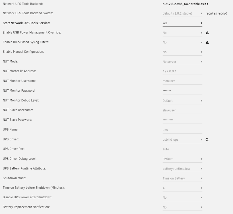

It is working with "Network UPS Tools (NUT) for UNRAID" under community apps plugin.
These are the settings to communicate with the UPS in the plugin.

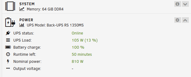

1 hour ago, kiwijunglist said:
I think there was another plugin that was depreciated, so I changed to the NUT plugin.
I see......I enabled the default feature ConnerVT mentioned it seems to work fine. I was trying to figure out what the NUT plugin ads to the default feature. From the screen shot you provided I cant tell what extra you get with the plugin.
Edited by xokia
It all looks very similar.
I think your dashboard screenshot looks a little bit nicer.

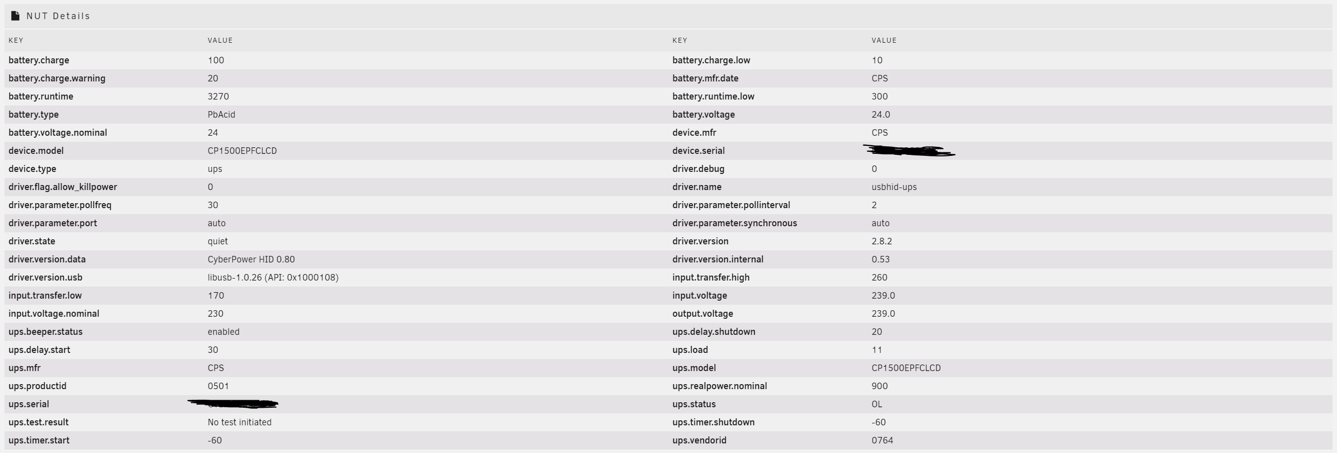

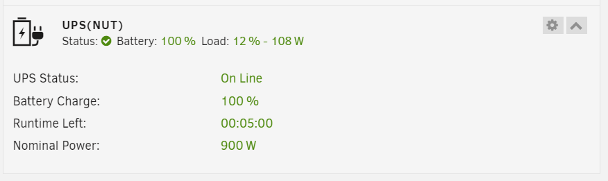

@kiwijunglist You may need a new battery.  5 minutes of run time reported is awful low for 100% battery on a 900W UPS:

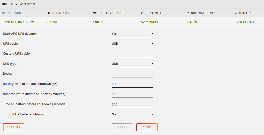

Here are my settings.  I let the server run on UPS for 6 minutes (Time on Battery).  If the battery level falls below 50% or the UPS says it has less than 12 minutes of runtime left I shut it down (this handles power on/off/on/off situations):

Thanks, you are right.  It should be ~40 minutes run time at ~100W load.
My server and unifi gear is usually idle at 36W so I guess usually it's 15 minute idle time on battery.
The battery is 5 years old, it runs 24/7, it would be extremely rare for it to be on battery power.  Eg. if I cut the power to do some electrical work for a little while then it would go on battery.  The cupboard does get fairly warm though usually around 25-30C in there, maybe up to 35C in extreme hot days.
