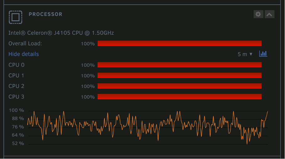

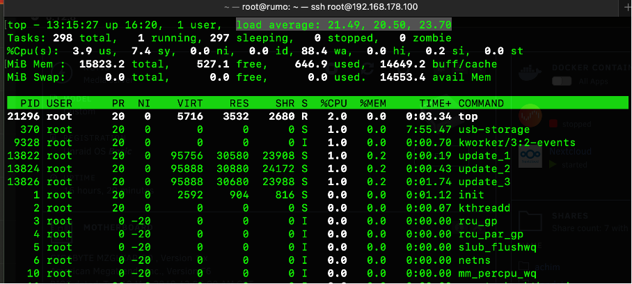

The system looks very busy in the dashboard,
whereas at the same time it looks completely different on the console.

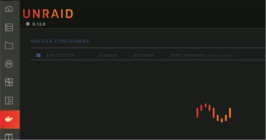

Sometimes it takes minutes to load the Docker tab.
In some cases only the page frame is loaded, but no content
In this case, the Docker box in the dashboard is also not loaded or remains empty.

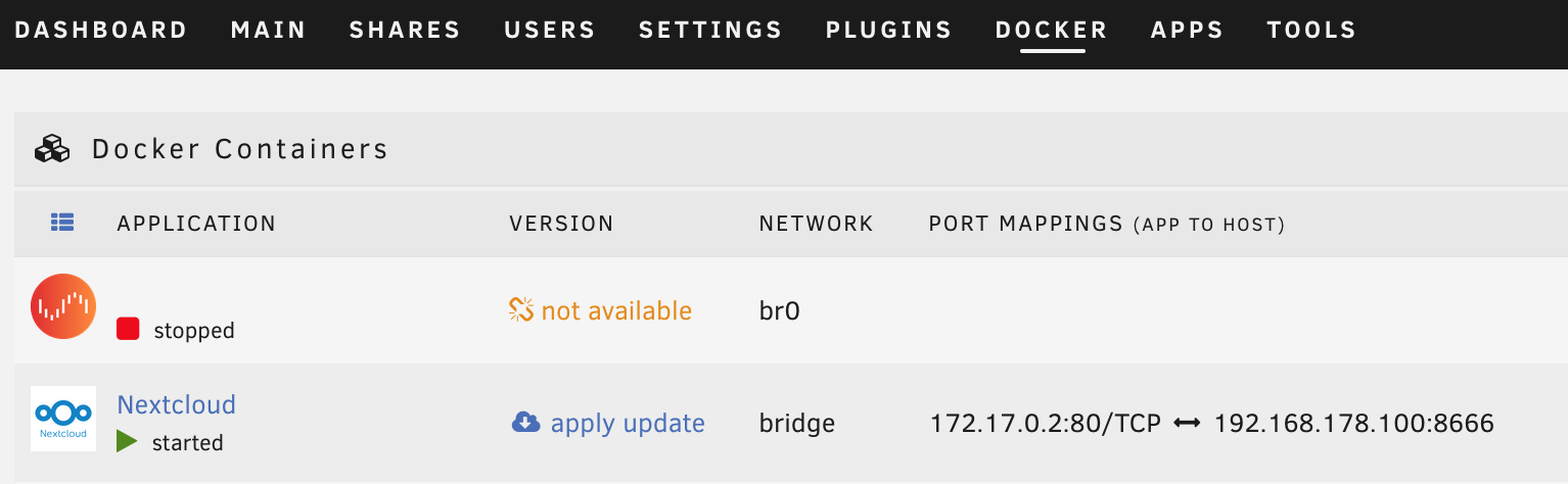

When I tried to start a third container, it would not start. Instead it looked like this:
