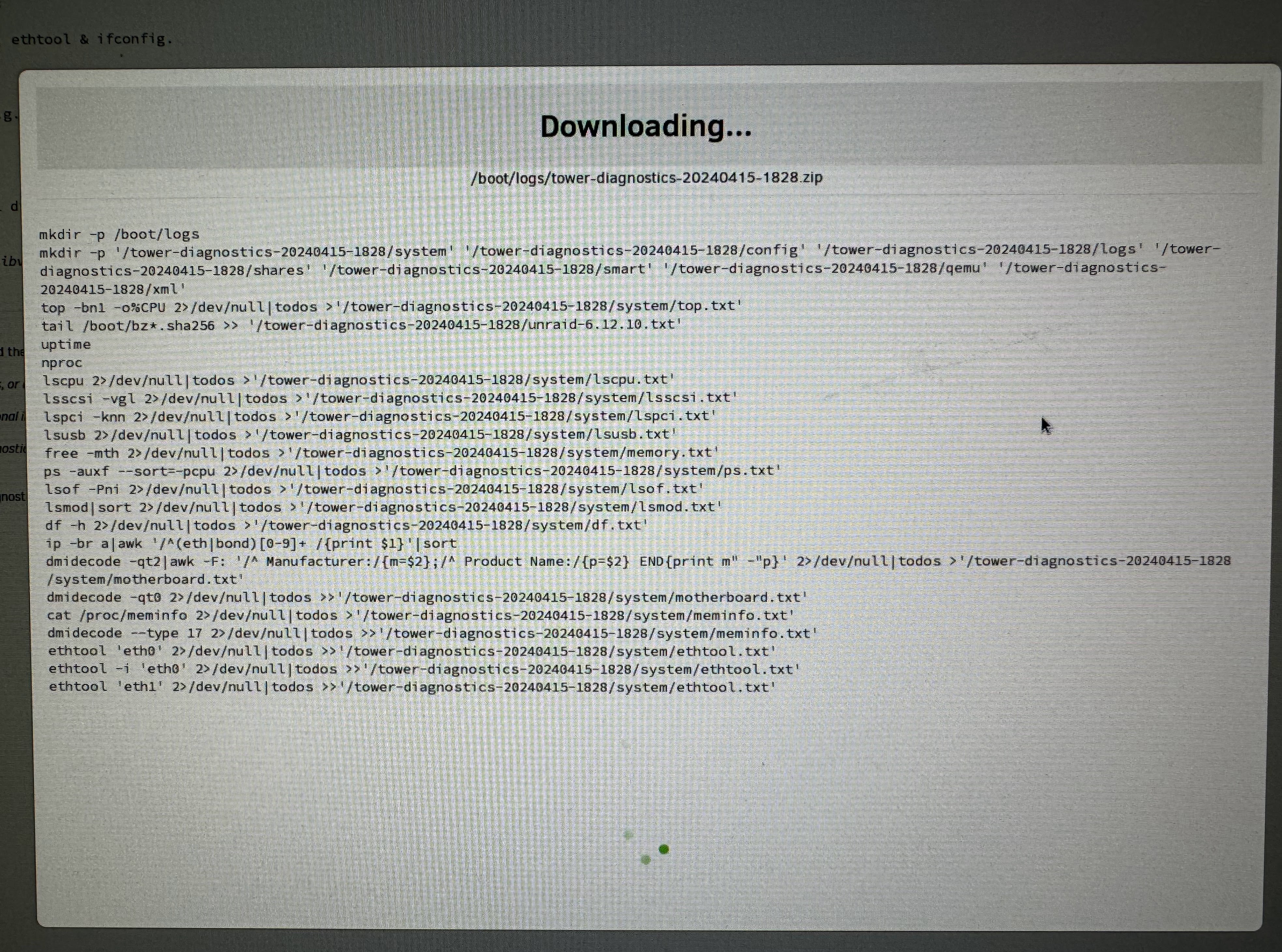

Every time I open Docker Settings or Network Settings, then my server becomes completely unresponsive. I cannot go to any page or SSH to the server either. I am forced to shutdown the server by holding power button. I have enabled syslog after last hard shutdown.
Even pulling diagnostics makes the server unresponsive. So I had to attach monitor and input to get the diagnostics. The server is frozen, so I could only take a screenshot with my phone... I will try to get the logs out to a file..
I tried removing subnets, and changing multiple docker and network settings.
Furthermore, I keep noticing 'eth1' as a culprit.
What else can I do?

Did not work. Same issues. Diagnostics gets stuck at
ethtool 'eth1' 2>/dev/null|todos >>'/tower-diagnostics-20240415-1911/system/ethtool.txt'
