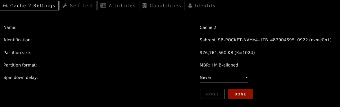

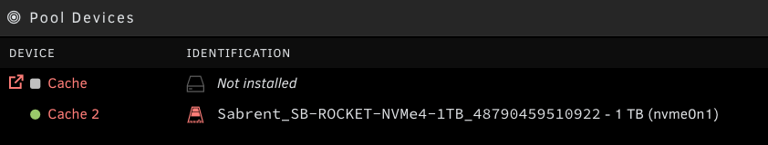

There's still something strange going on there, leave sdi disconnect for now, unassign both nvme devices, start array, stop array, re-assign only /dev/nvme0n1p1 to the old pool, start array, post new diags
Ok, sdi is still disconnected. I unassign both nvme devices, started array, stopped array, then re-assigned only /dev/nvme0n1p1 to the old pool (in it's original slot 2 of the pool), started array, and it started with no errors. New diags attached.

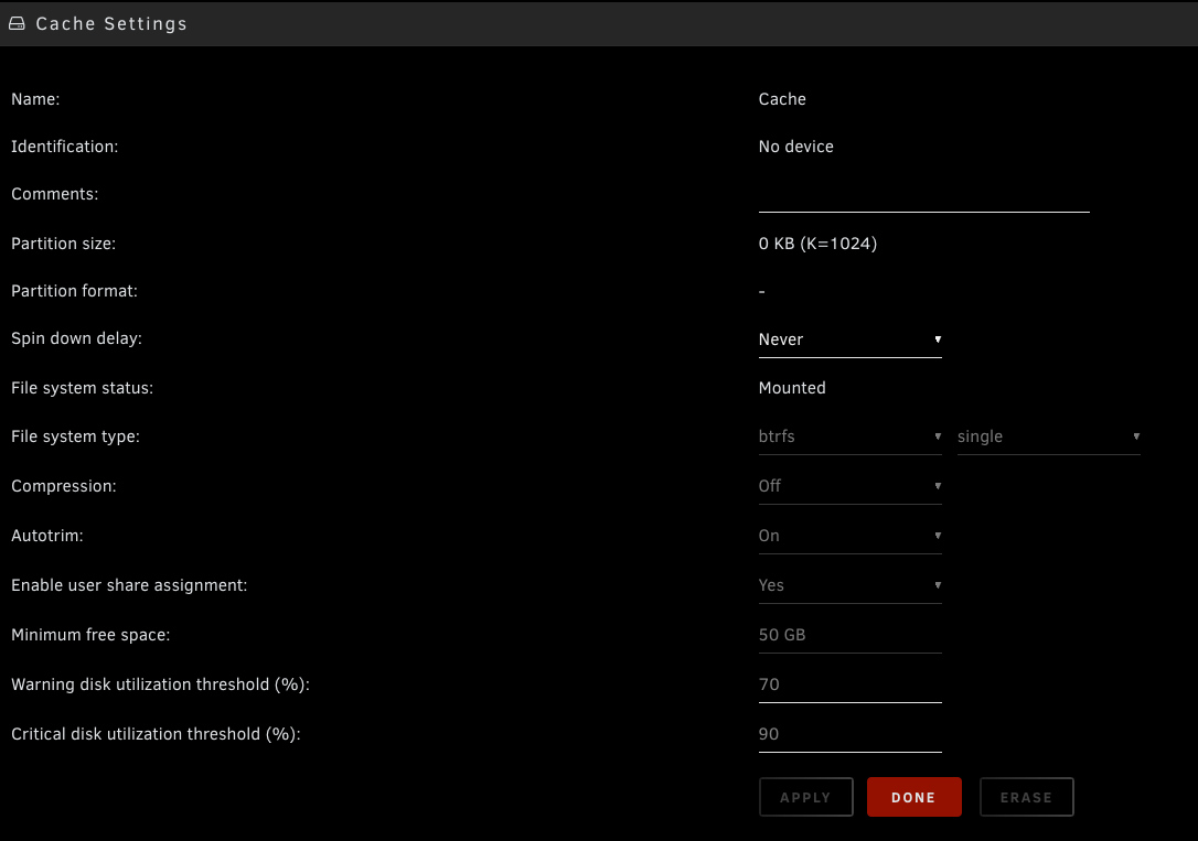

Ok, sounds good. One question, when I add the other nvme device back to the pool, do I need to do anything in pool setup? Right now the pool setup (in slot 1) shows File system type: btrfs single. Would I need to change it to Raid 1? Or will Unraid just handle to change? Also, is there any reason to move /dev/nvme0n1p1 to slot 1 in the pool before adding the second nvme drive?
Just added and start the array, it should automatically create a mirrored pool (raid1).
One more issue. When I add second nvme drive and try to start the array, I get an error:
Wrong Pool State
cache - too many missing/wrong devices
That should not happen when adding a new device, something weird still going on there, try this:
Unassign the second nvme device, also wipe it with wipefs -a, set pool slots to one, start array with just the 1st device, stop array, set pool slots back to 2, re-assign 2nd device, start array, if it doesn't work post new diags.
