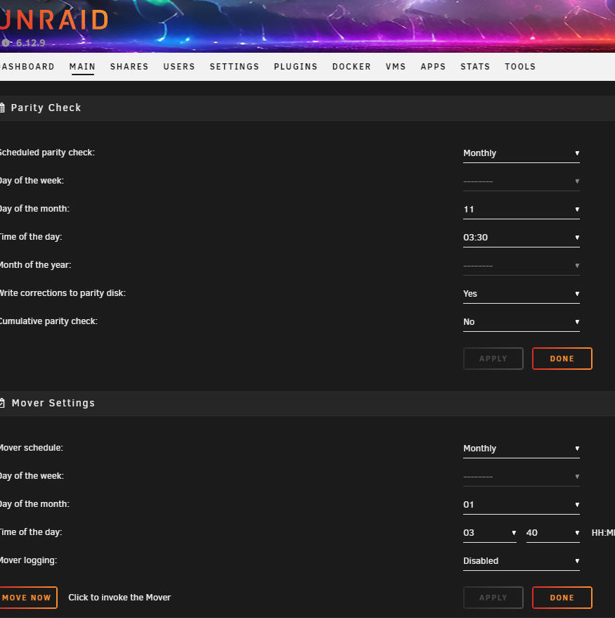

If it is not just at boot time but while already running then perhaps you should post a screenshot of Settings->Scheduler->Parity Check in case you have not got it scheduled as you think.
here is my scheduled settings - Im not sure how to get into the flash drive logs - thanks  again for your help

Those look fine from a scheduling perspective.
We do normal, however, recommend that the automatic scheduled checks are set to be non-correcting so that if you have a drive playing up it does not end up corrupting parity before you realise there might be an issue.   Then it is only the manual checks that are set as correcting after you have fixed any hardware related issues that might have caused parity to be partly invalid in the first place.

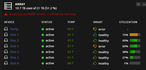

I had been waiting on a secondary PSU for the replacement build, but I decided to forego that and instead transferred the flash drive contents to the new board. I then installed the old drives into the new case and powered it on. To my delight, the Unraid system sprang to life seamlessly – it's truly a marvel. Now, with everything up and running smoothly, my perfectionist tendencies have me pondering one final question: how can I eliminate these lingering errors from the old system? They stem from power cable issues, which were part of the motivation for the new build.

You can click on the thumbs down to acknowledge the current errors, it will change again if new ones come up.
