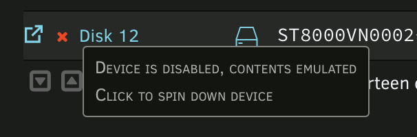

Today I have a broken disk

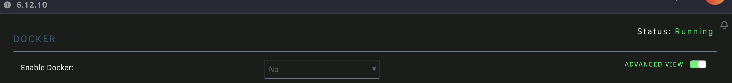

I'm trying to stop the docker service and the array but when I try to stop docker I'm in the following situation:
599185689_Screenshot2024-04-17at15_04_52.thumb.png.09126524d14922d1afcf5108e6044e4b.png
Docker should be down but its status is "running"

What can I do to replace the disk, or to force to stop the array?

emhttpd crashed, you will need to reboot to get the WebGUI working, type reboot in the CLI, if it doesn't reboot after 5 minutes you will need to force it.
forced reboot will invalidate the parity? the data from the broken disk, in case of invalid parity, will be lose?
If you do it after typing reboot it should be OK, since most times it can unmount the array disks.
all works now ty
