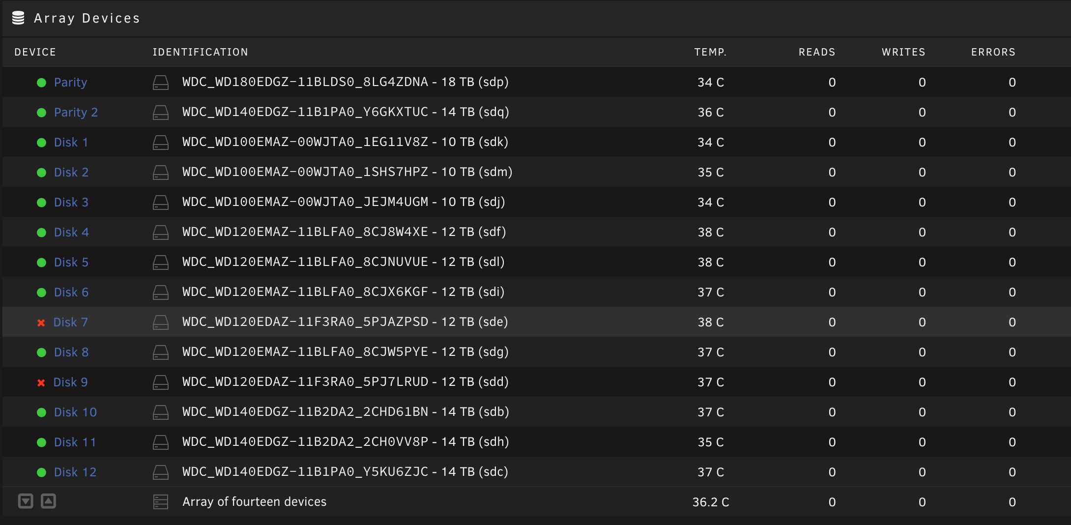

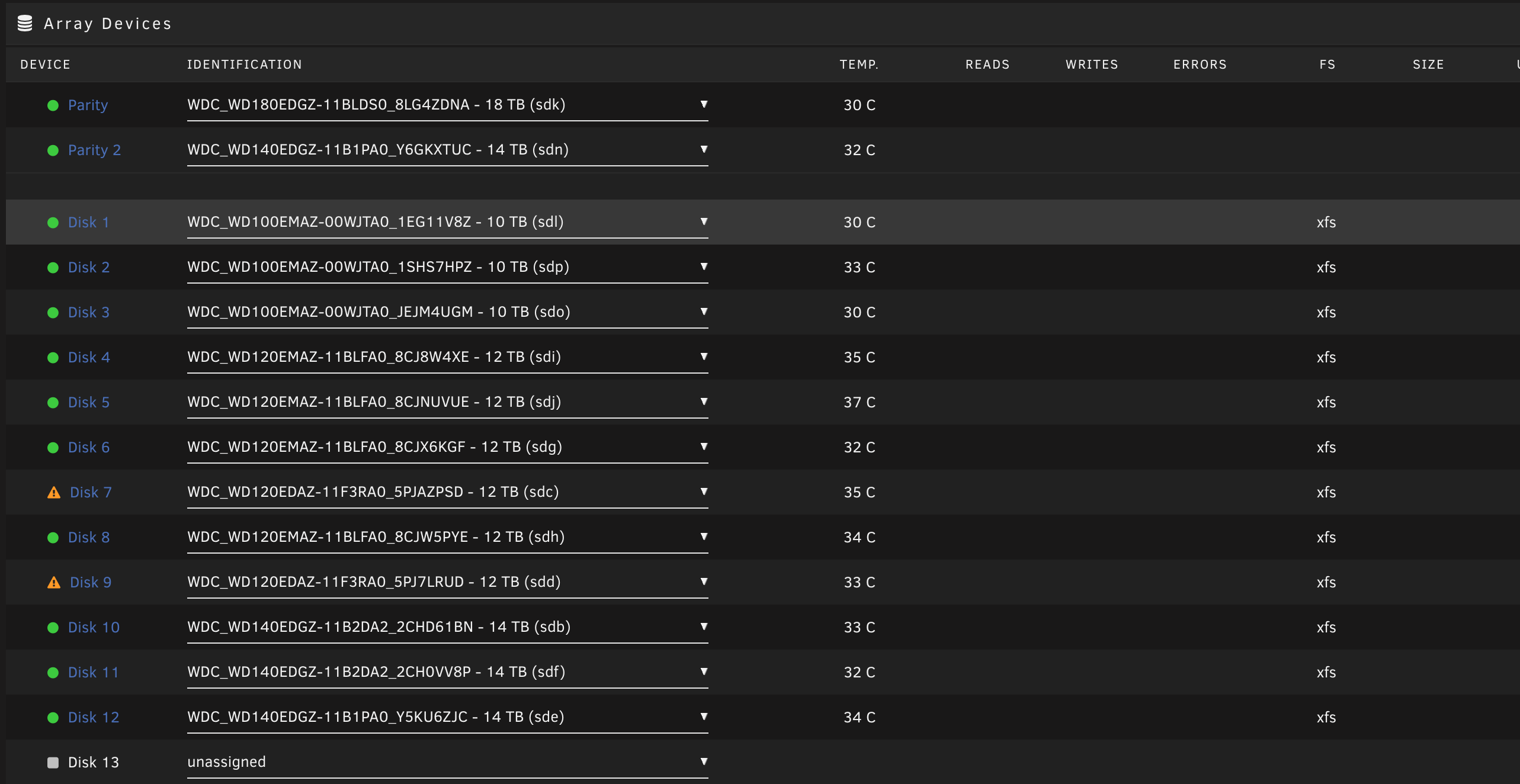

Ran out of free ports so I recently added an Intel RES2SV240 SAS-2 Expander to my LSI 9207-8i in order to add a new 18tb drive to the array as Parity 2 and move the current 14tb Parity 2 drive to a data drive. Dual link sas connection from the expander to the hba and new sas to sata breakout cables. Expander plugged into pci slot for power. After setting everything up and booting up the system all drives were recognized but 1 drive was disabled and there were crc errors. I changed out the sata breakout cables and checked all connections and now 2 drives were disabled. Smart test completed without error for both drives. Ended up running the check filesystem on both drives with -L. Drives are now mountable but contents emulated.
When attempting to rebuild the drives from parity the webgui eventually becomes unavailable. Server does not appear to be on the network anymore. I also have a pikvm hooked up to the server and the unraid console there is also locked up. I have let it run the expected rebuild time hoping it would recover but did not and eventually did an unclean shutdown.

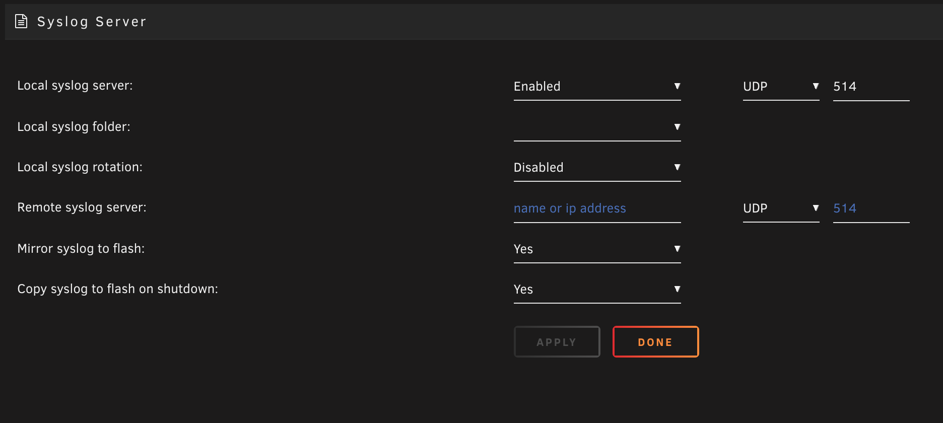

The syslog in the diagnostics is the RAM version that starts afresh every time the system is booted.  You should enable the syslog server (probably with the option to Mirror to Flash set) to get a syslog that survives a reboot so we can see what leads up to a crash.  The mirror to flash option is the easiest to set up (and if used the file is then automatically included in any diagnostics), but if you are worried about excessive wear on the flash drive you can put your server's address into the remote server field.
I looked at the syslog previous and didn't see anything obvious but I don't know exactly what to look for. Any thoughts on next steps?
