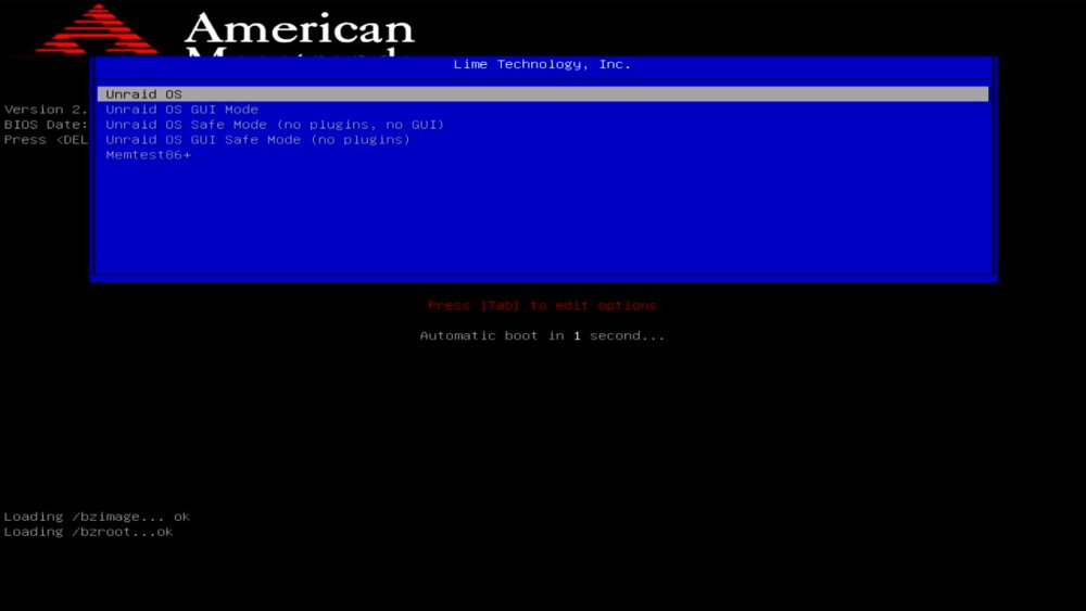

It seems however that something is really off booting Unraid on my system, as two times out of three the boot sequence gets stuck at `Loading /bzroot...ok`

Try a different flash drive, just to test, no key needed, also look for a BIOS update.
You can also try rewriting the bz* type files as described here in the online documentation accessible via the ‘Manual’ link at the bottom of the GUI or the DOCS link at the top of each forum page.
Just to followup on the above, the issue was a faulty RAM stick.
Removing it from the system solved the boot problem all together.
