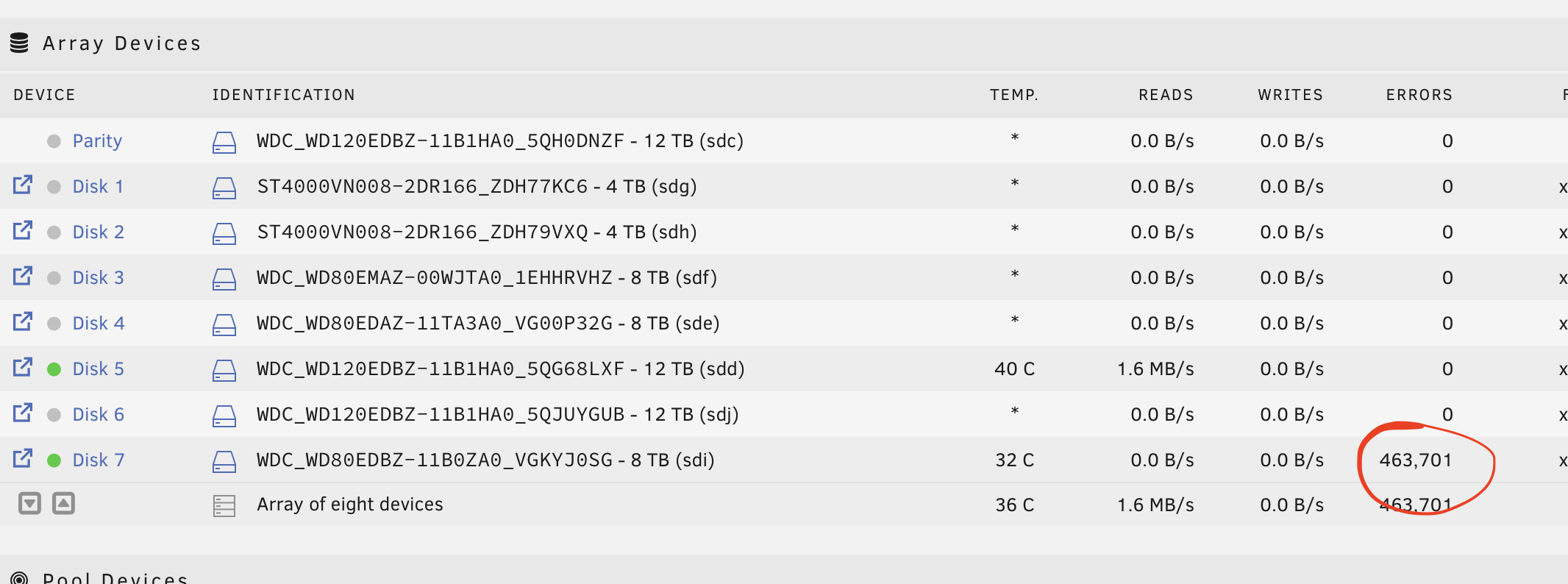

Subject: Notice [VALIS] - Parity-Sync finished (463701 errors)

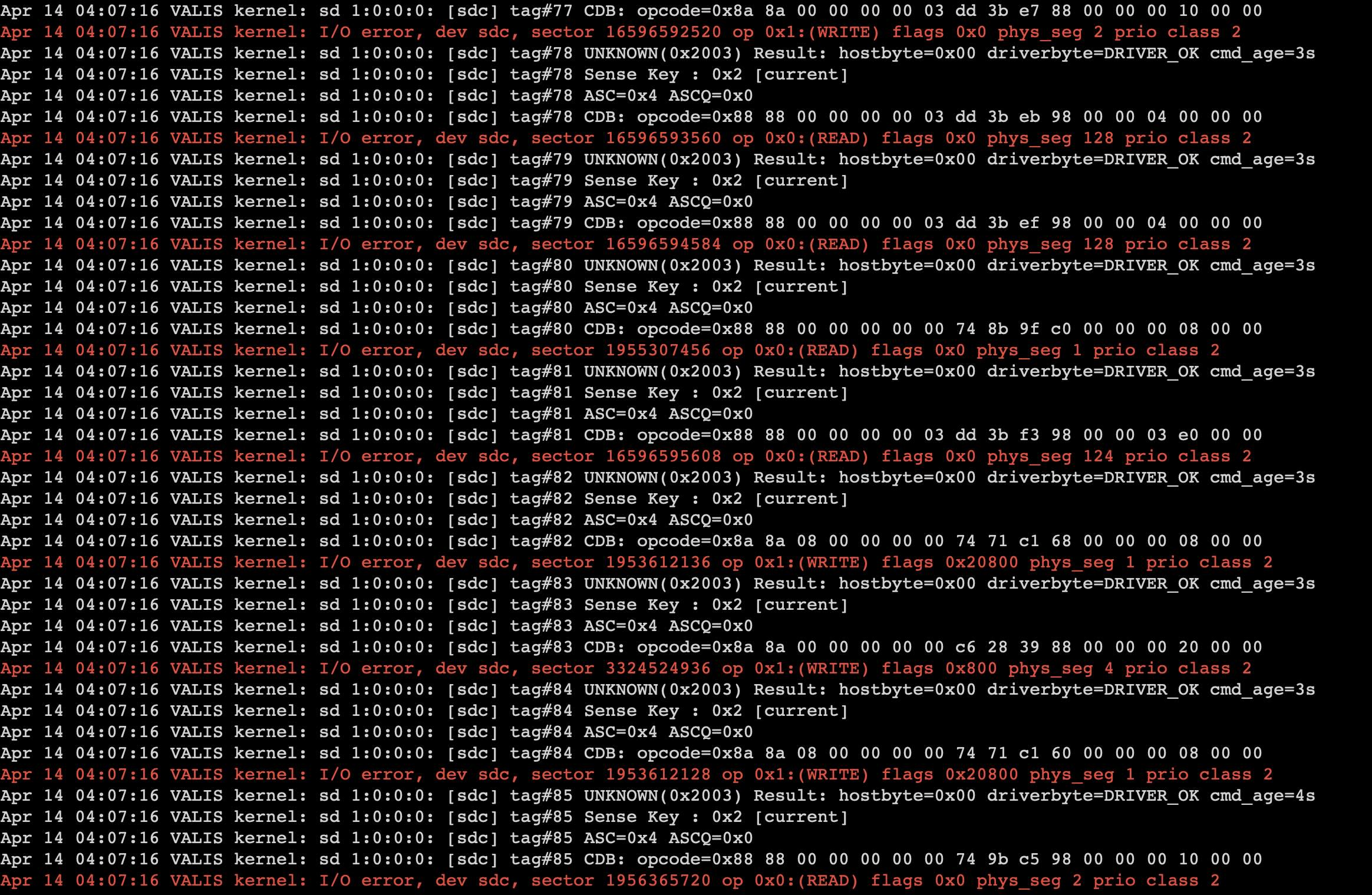

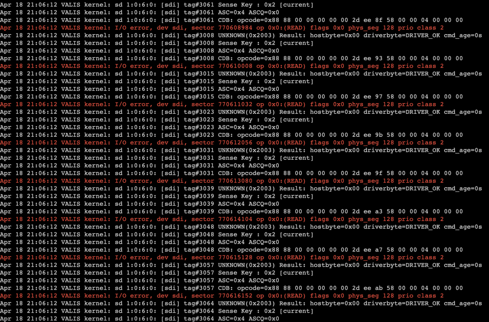

I found some screenshots I made in the process
“old” parity drive error log, taken on Sunday:
data drive error log, taken on Thursday evening:
are those serious? is there anything to be done?

Diags show errors with disk7, don't see any with parity, disk7 errors look more like a power connection problem, replace cables (also do it for parity) and run a parity check.

How do you know disk7 errors look more like a power connection problem? Is this based on the screenshots I provided, or do you see any indications in logs? The reason why I’m asking, is that I would like to know, if the “old” parity drive can still be used as future replacement. Errors on both old parity drive and disk7 looks very similar on my screenshots, so maybe the old parity drive also only had power connection problems?

Continual resets on a drive showing up in the syslog are typical symptoms of power/connection problems.

how do I get rid of these tho?
Stop and start the array, or shutdown and reboot. Can't remember if just stopping and starting clears the error column, but I think it does.
