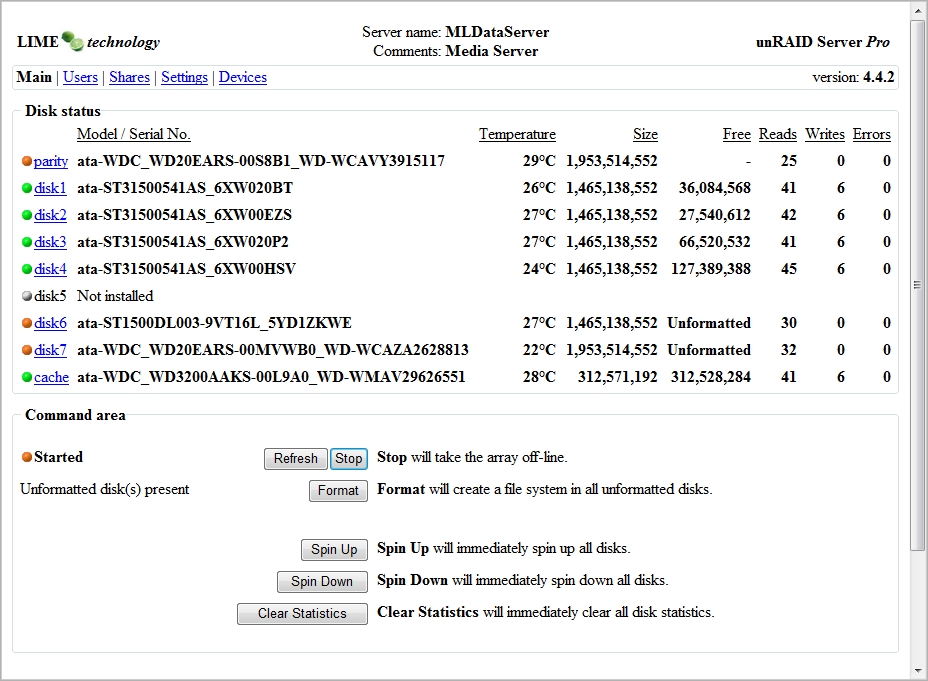

Looking for some assistance.  I've got a system that I had two orange dots yesterday (one of them is the parity) and while trying to resolve I've now got 3.  Running Version 4.4.2.

I've already tried reseating all the hardware, replacing sata cables, replacing the sata drive bays, replacing the sata card.  Only thing left is to replace the power supply and motherboard.  Things seemed to go down hill after installing the 2 TB WD drives for me a while back.

So I tried to run reiserfsck --check on Disk6 and Disk7 [reiserfsck --check /dev/md6 & reiserfsck --check /dev/md7]and they both reported the following:
bread: Cannot read the block (2): (Input / Output error)
Any thoughts about where to go from here?

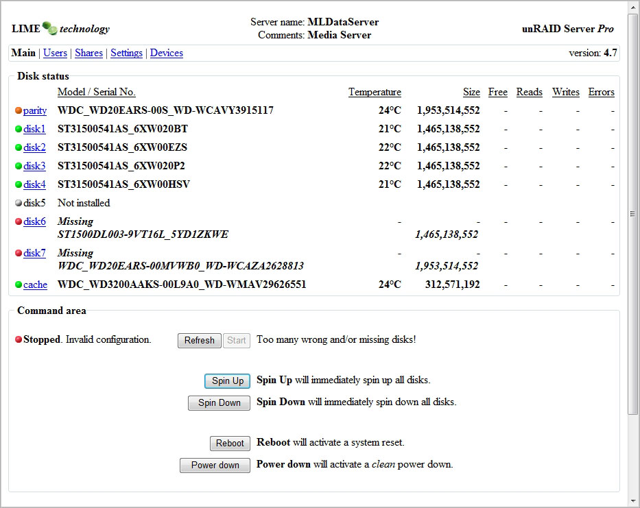

Ok, when I updated to 4.7 and followed the instructions above, 4.7 reports those two drives as missing.  This may be why the smart reports didn't run properly?
Does this provide any clues?

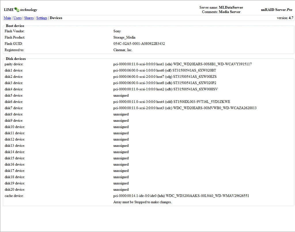

I've updated to 4.7 - the same three drives are orange although their SDx assignments are slightly different on the newer ASUS motherboard.  sdd and sdc are now the orange data drives.

Here's another revised look at the Devices tab.
