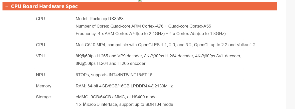

I'm looking to potential buy and test a new nas smb board:
https://www.friendlyelec.com/index.php?route=product%2Fproduct&product_id=294
I'm curious if the emmc could be flashed to unraid as a usb boot device.
i've seen raspberry pi 3b board run unraid before in the past and talked about... but not sure if current 6.12 is capable.
Either way i think this would be a cool project to test. Was looking to know if there is arm support in the kernel.
have a cm4 may try that as well but this looks promising to have 4 nvme disk and a decent arm processor to run.

Unraid is x86 not arm unless was running under qemu not sure how it was running on a pi
if i remember correctly they were using xogear a x86 emulator.
Kernel 6 has arm code, it more about the Linux applications that unraid runs.

That is using qemu to emu!ate x86 on arm. So running as a vm.
