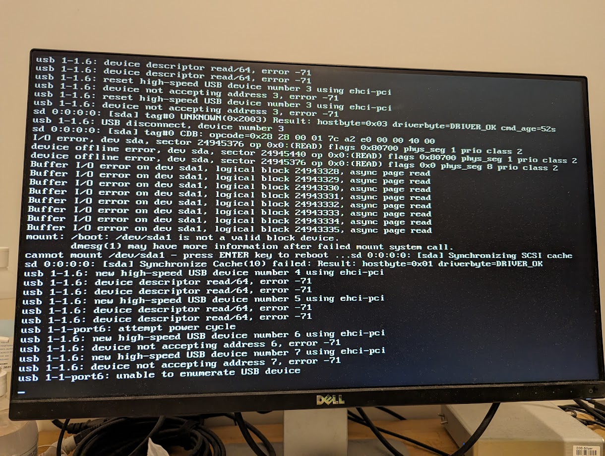

I came home with my unraid server unresponsive, so I have rebooted my computer and was met with the picture below. I've tried inserting the usb in a 2.0 slot behind the motherboard and in front of the case IO but the results are still the same.
I am thinking its my USB that has failed after a year of 24/7 use.

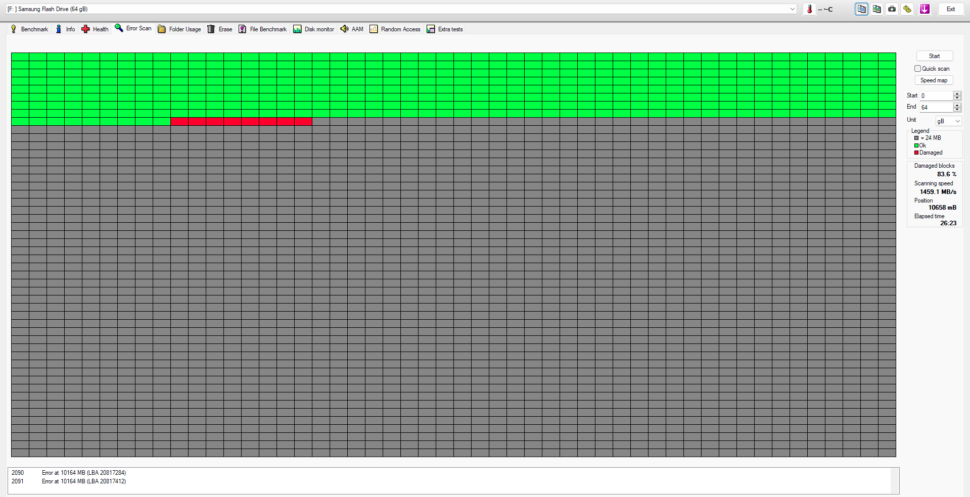

I use Unraid connect which has a backup from 2 days ago, how would I go about installing the same config and everything on a new USB drive? Do I have to move some files from the old usb to new usb?
