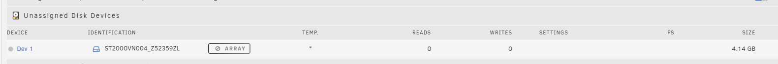

Also, noticed that there is 1 Unassigned Disk Drive showing as sdh  which has the same serial number as Disk2 but tagged as sdg

Stopped the array and Disk2 shows up as missing though the same drive shows up in the Unassigned Disk Devices as a 4.14GB drive.
I now have an invalid configuration and cannot start the array.
Disk2 is still generating ATA errors, and not even giving a valid SMART report, looks to me like it's failing, and since you already have another disk disabled you will likely have some data loss, you can try using ddrescue on disk2 to try and clone it to a spare, if that works there's then a chance to recover disk1
