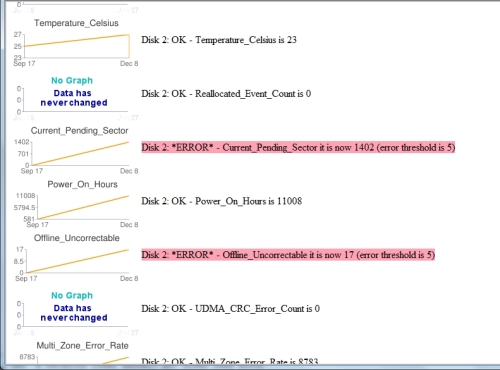

I've noticed my Error count on the rise on my Disk 2 of my array (61k at this point).  I don't know exactly when it started to go up, but I *think* it's when I moved some data from Disk1 to Disk2.  I don't believe I had any errors at all a month or so ago.
I've read that this might be caused by a temporary READ error/parity issue, but I could be mistaken. Reference: http://lime-technology.com/wiki/index.php?title=Troubleshooting#Obtaining_a_SMART_report
When I check the syslog I see "UNC" codes, which potentially point to a bad sector.  So I ran Smarthistory and I do have some error that I cannot interpret.  "Current_Pending_Sector" and "Offline_Uncorrectable".
I'm at a loss...do I have a drive that's going bad?  My other specs are in my signature
I've attached a partial syslog (mine was 9MB and not compressible to the file upload limit) and a screenshot of the smarthistory of the errors.
Your help is greatly appreciated, as always.

Yes, you should be worried. It very much appears you have a drive going bad.
If possible, you should get that drive replaced as soon as possible.
Once successfully replaced, you could then try some tests on it to see what becomes of it if you so desired. Personally, I'd just RMA it and get another one.

I agree.  It needs to be replaced... ASAP.

Move your data off that drive as soon as possible.
Schedule drive replacement.
Should you have any other hard drive failure, the one in question may not be readable to reconstruct another drive.
