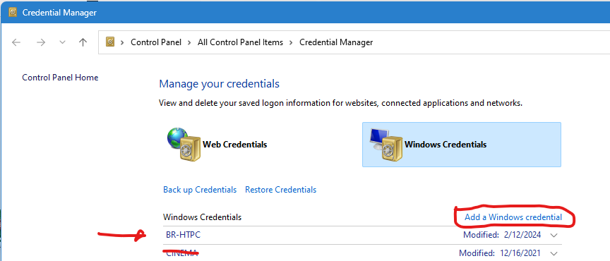

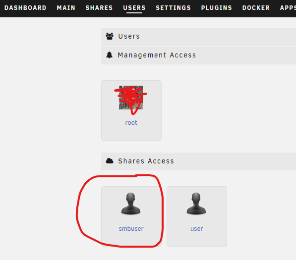

Windows will not permit a connection to a server using a 'guest' account (connection without a login to the server).    Try this:
Add a Share Access user to your Unraid server:
Using   Windows Manager, add a Windows Credential:

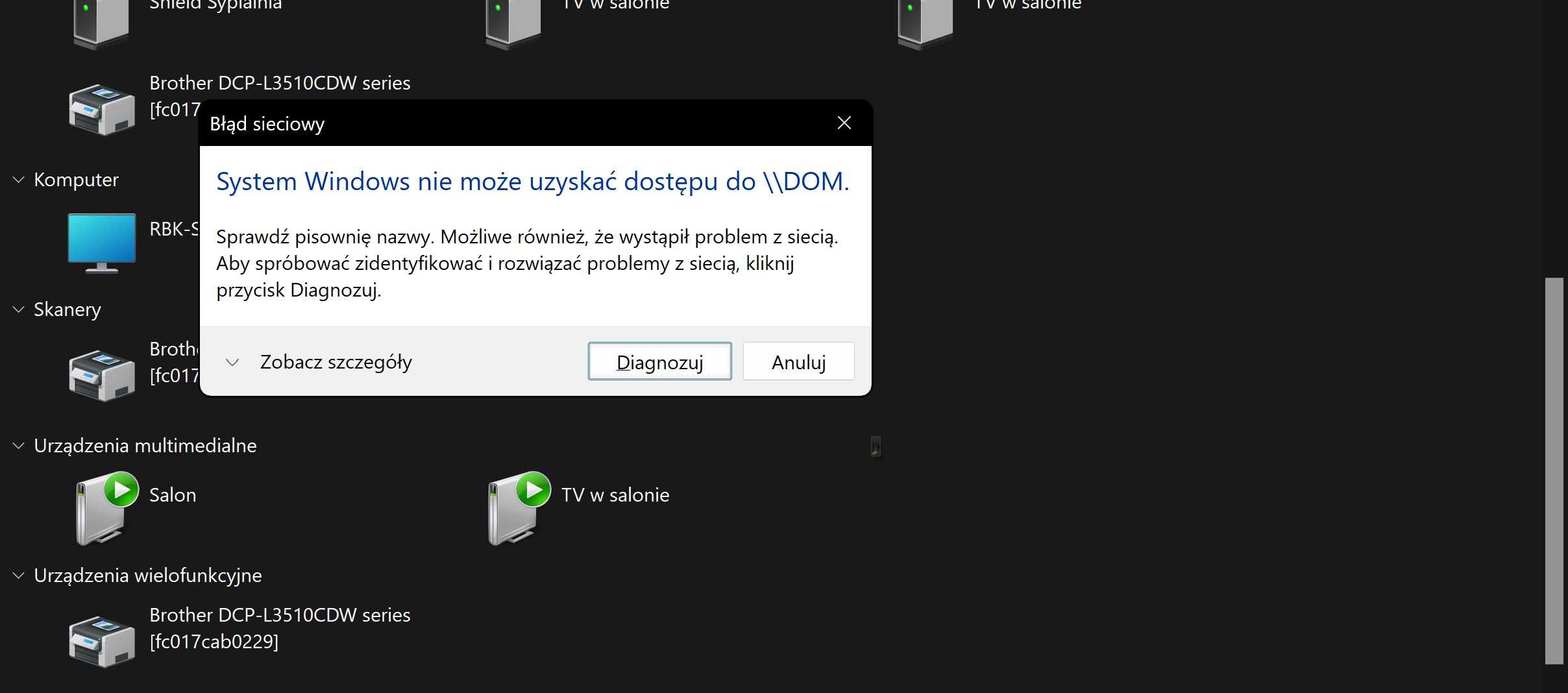

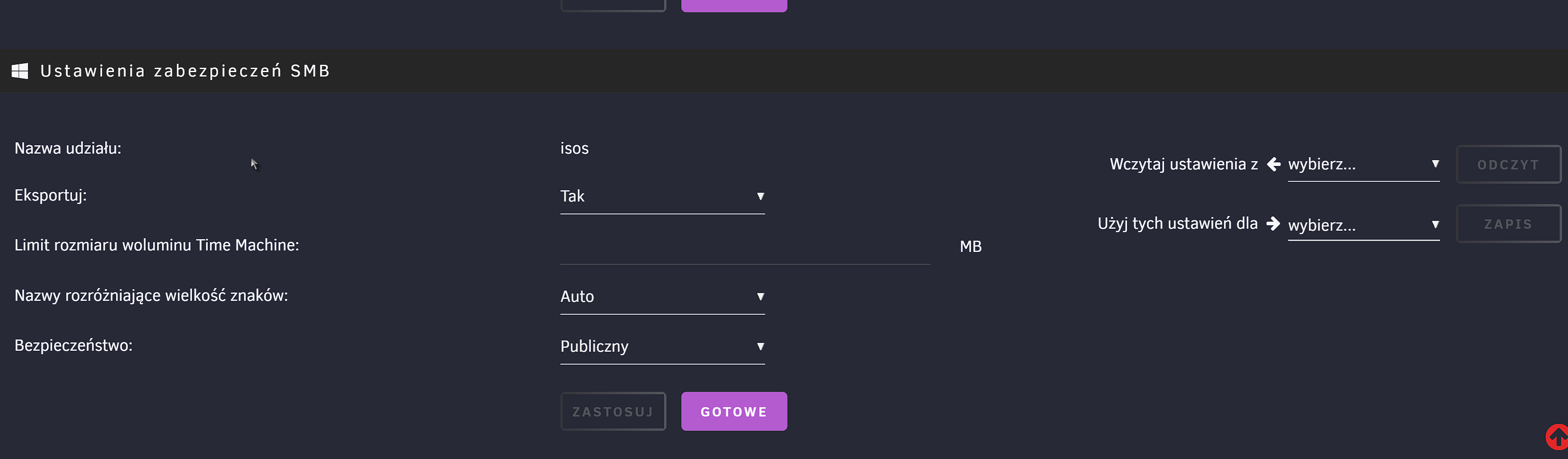

I setup new unraid serwer i make all updated.

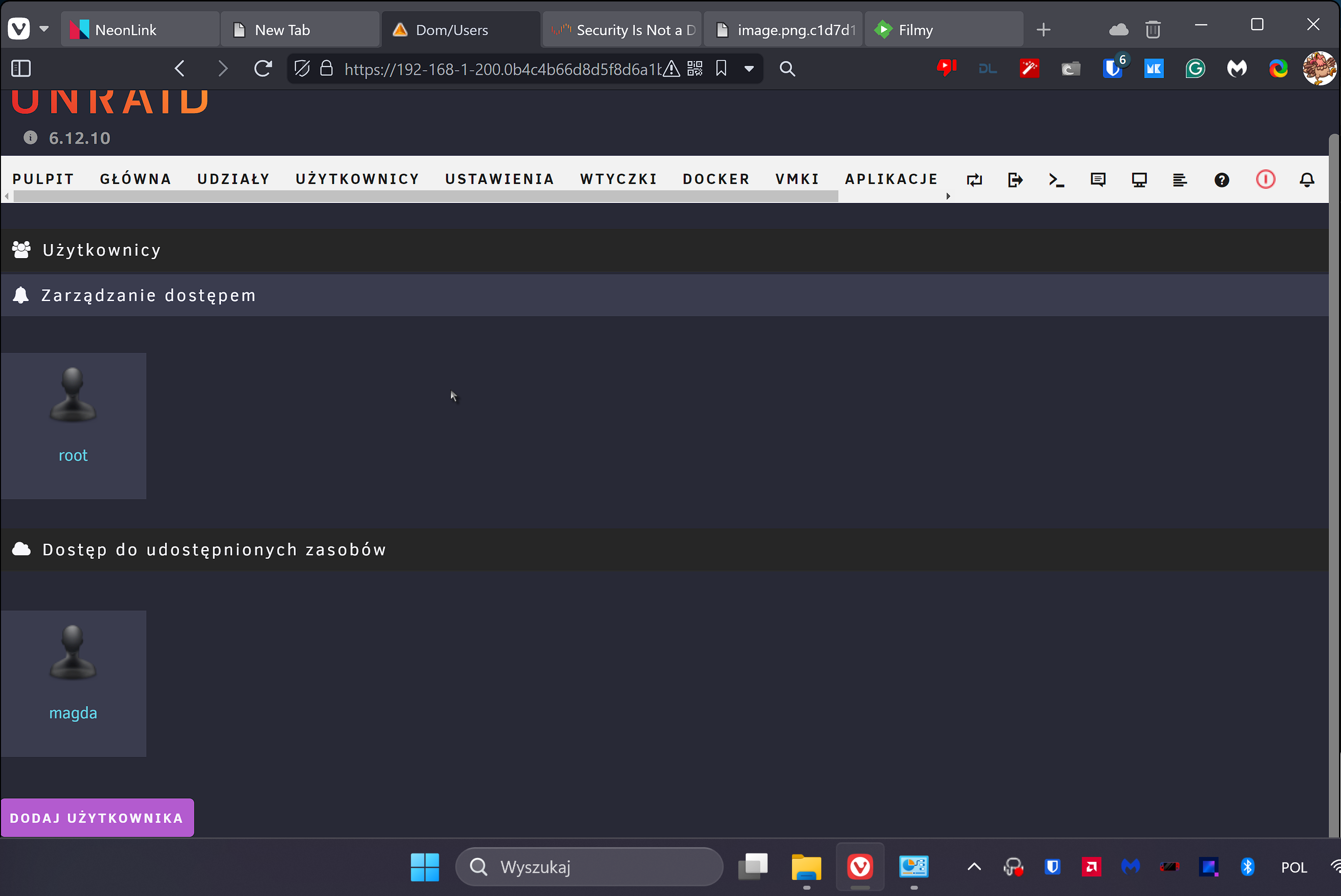

I create new user add share (smb) and cannot acces to this share from windows 11 and think is windows issue.

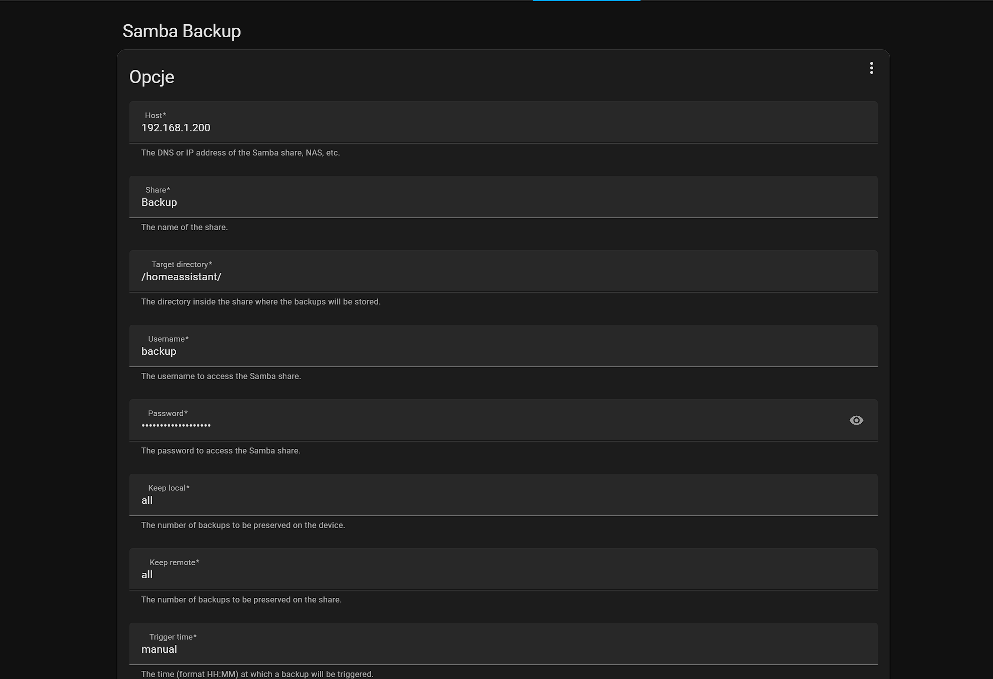

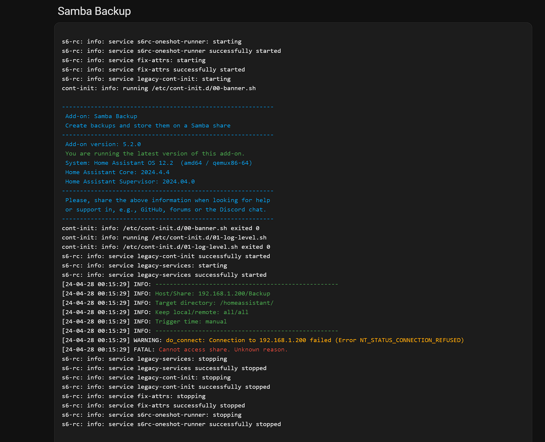

In mean while I setup VM Home Assistant is work on linux.  I install Plugin Call Samba Backup and his backup all system via smb.

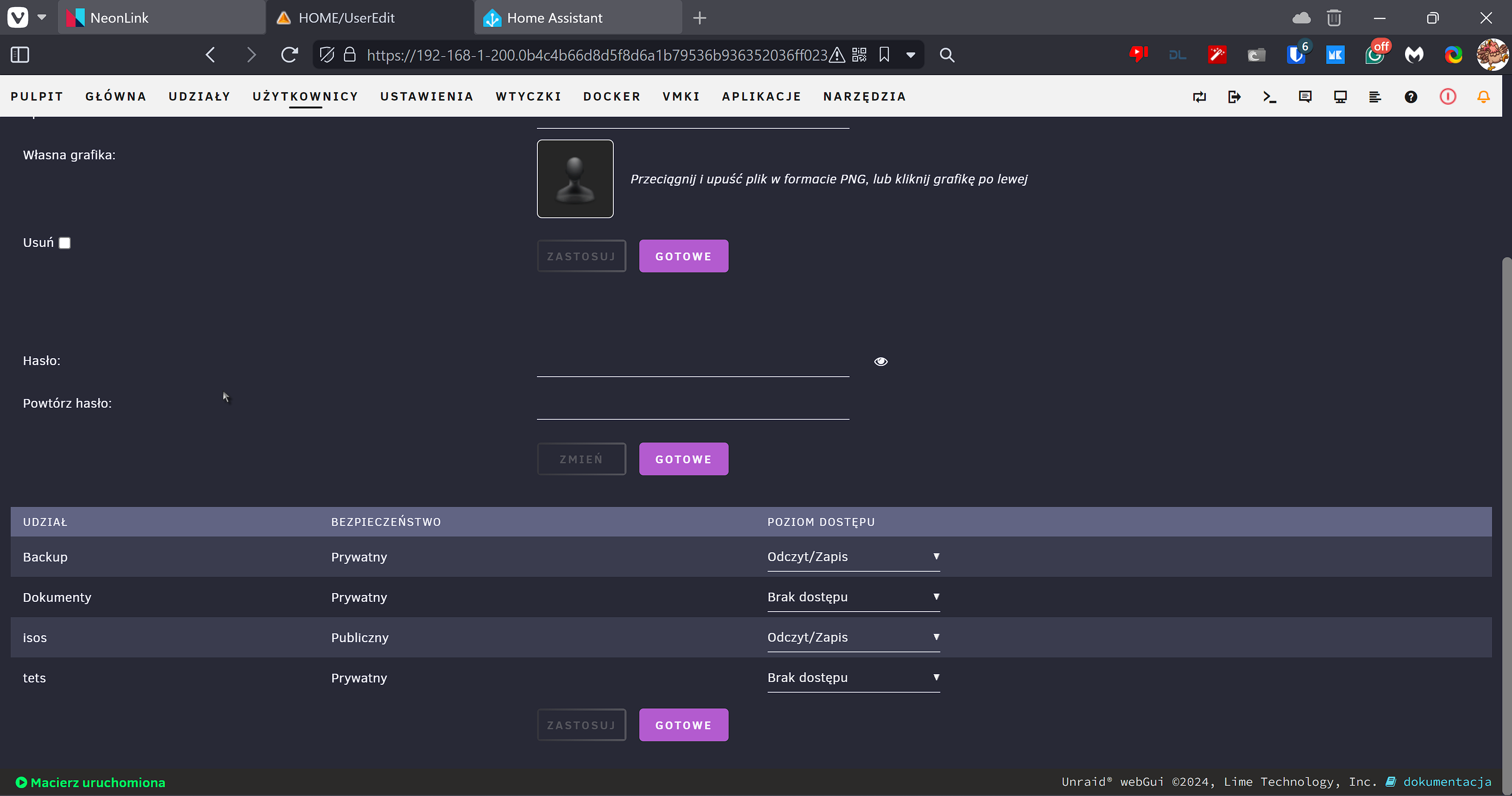

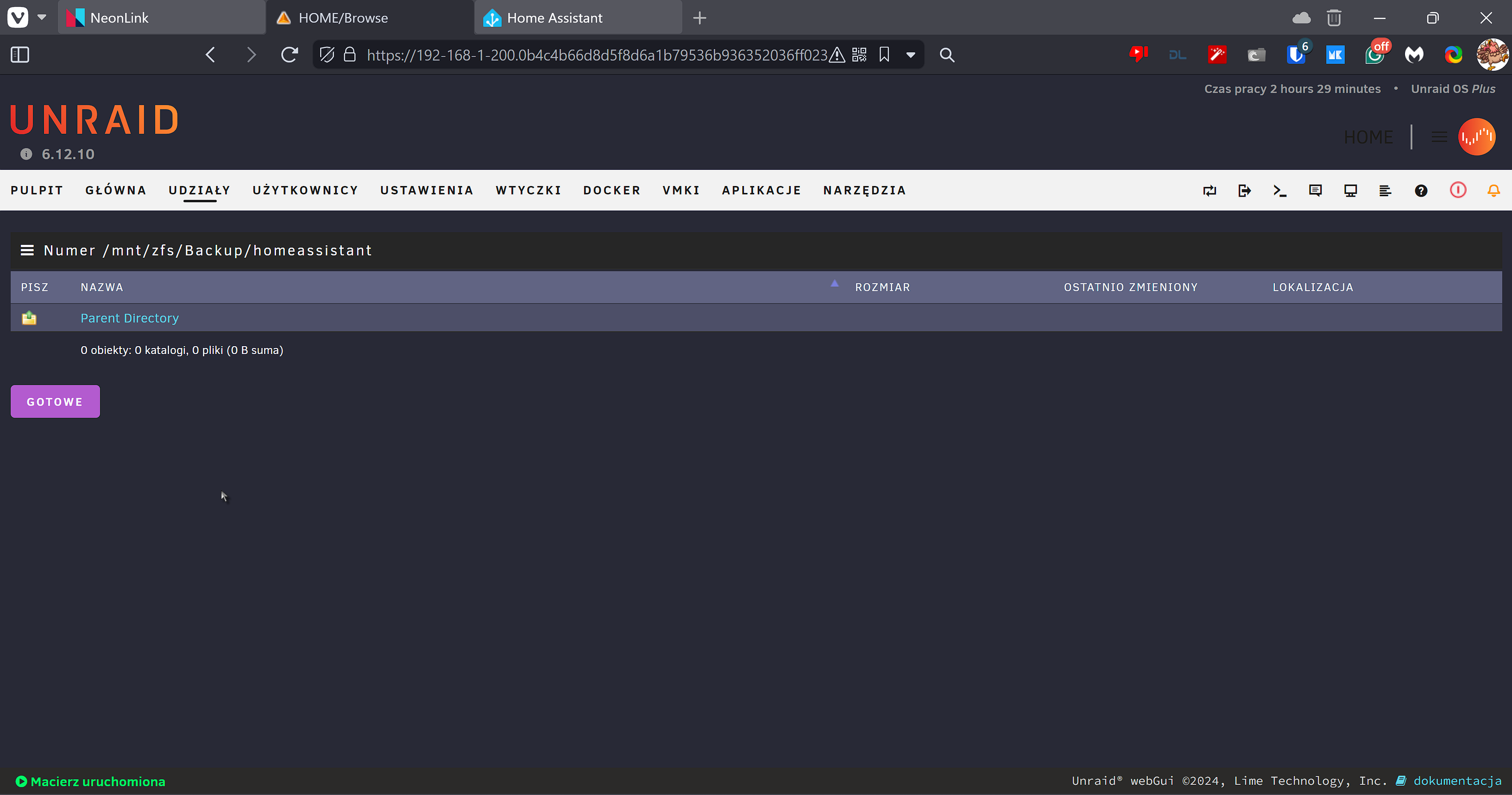

I create new user called Backup (user backup got rw rights) make shares Backup/homeassistant.
I check 3 times  is password match. When start plugin I got messedge cannot acces "unknow reason" I log screen from samba backup app

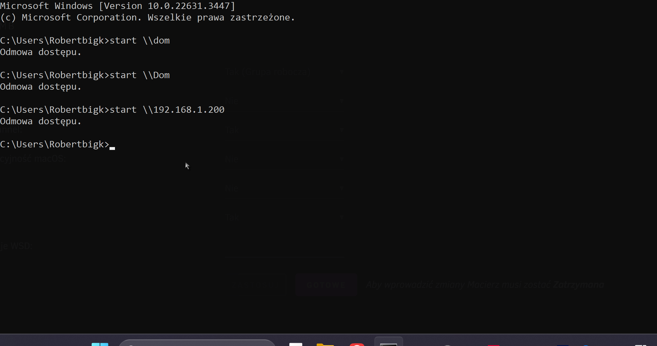

Than I want to tell I cannot acces to new samba shares from windows and linux base system.

All setting is 100% match and on RBK-Serwer all samba shares works. New serwer HOME I try this setting and cannot acces to shares or make backup via linux to samba share.

What share are you trying to connect to?
How are you connecting?  I hope you are using Windows File Explorer.  Also called Windows File Manager.
Do you have any Mapped Drives to this server?
It is also important that you restart the Windows computer every time that you make a change to either your server or the Windows computer.  (Many times, once Windows SMB is set up, it refuses to make any changes to its configuration without a restart.)

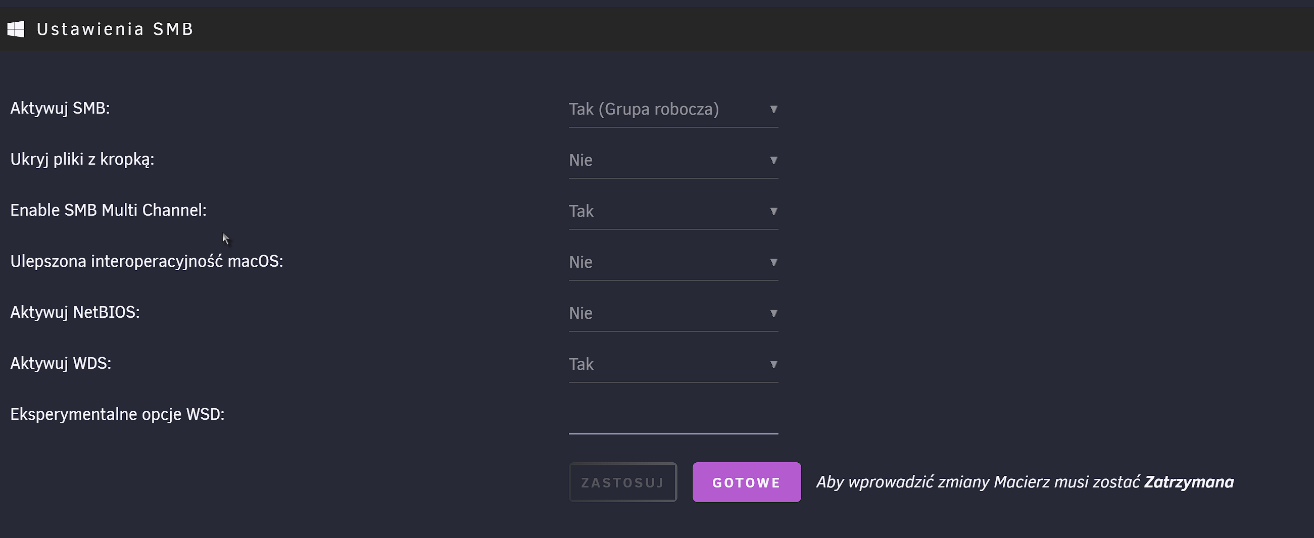

You have "macOS Interoperability" enabled on rbk-server, but not home.  This would be enabled if you want to access SMB shares with a Mac.  If you only use Windows PCs, turn it off.
Yes RBK-Serwer got wireguard setup that 10.253.0.1
 I enable disable that on HOME "macOS Interoperability" no difference not work.
Sure i can disable that and disable that for test not help "Turn off Enable SMB Multi Channel" When I have not ON this option i got all time probles on my base serwer "Random" You not have rights to  Create file , folder or some copy in windows machine

Sure i can disable that and disable that for test not help "Turn off Enable SMB Multi Channel" When I have not ON this option i got all time probles on my base serwer "Random" Create file , folder or some copy.
SMB Multichannel off should have nothing to do with creating folders or copying files.  That doesn't make much sense.
Yes You right is not make sense but simpe test folder "Documents" I go to this folder from windows and got "You dont have rights to create folder"
or file. When I enable multichanel I go to that same folder create folder and is works. Im not developer just try ON and OFF and see works defference.

If that is happening, you have other problems being masked by having it turned on.  I would suggest you are dealing with network issues.  Multichannel is a feature of SMB to use several NICs to enable multiple channels to be open at once and has nothing to do with permissions.
