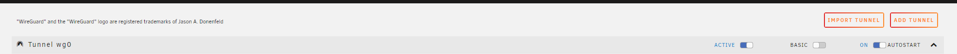

are you using unraids vpn server?
you can achieve this on how wg0 on unraids connects to lan network and docker services over the vpn if Unraid is vpn host.

I'm not. I thought the built in VPN service in unraid was as a server, rather than client (i.e. can be used to access unraid from WAN, rather than to allow unraid to connect to the web through a VPN), is that not the case?
depends how you use the vpn server. you can setup a site to site vpn with 2 servers.
it bit hard to setup but doable. Technically, all vpn servers are clients too. it's all in the config file.
https://openvpn.net/vpn-server-resources/site-to-site-routing-explained-in-detail/
you would import the config file form your other vpn server into unriads. Create a peer connection to import in too your current VPN.
then allow lan access via unraid.
