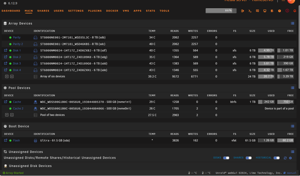

Sorry, it's the other one, nvme1 and nvme0 are swapped in the screenshot vs. the diags.
Seems this one has some errors
homeserver-smart-20240429-2123.zip
SMART test passed, but it's giving write errors, since the pool is not redundant, I would recommend copying anything important from there and then recreate with just the other device.
