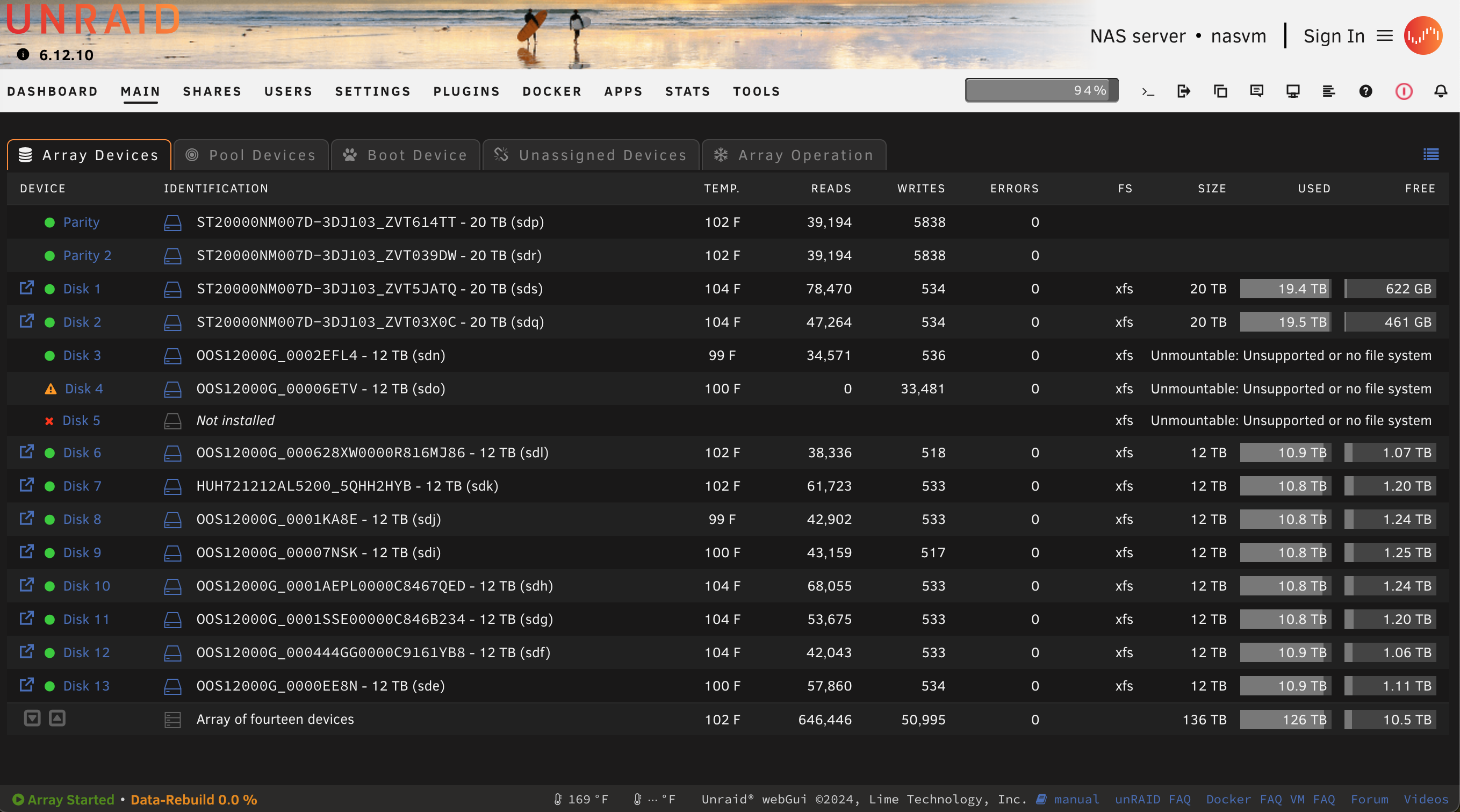

I just ran into an issue with rebuilding a drive. I have an array with dual parity disks. I had 2 disks exhibit an error. This has happened before and I usually rebuild one then when complete rebuild the other. In this case the disk was partially rebuilt and I noticed some array data was missing. I stopped the rebuild, rebooted the server and saw that 3 disks were unmountable. Something is causing my disks to drop out of the array and now I'm in a state that I don;t know how to recover from. I've attached diagnostics in case that might help diagnose the issue.

Diags are after rebooting so we can't see what happen, but check filesystem on those 3 disks, run it without -n, and if it asks for it use -L.
