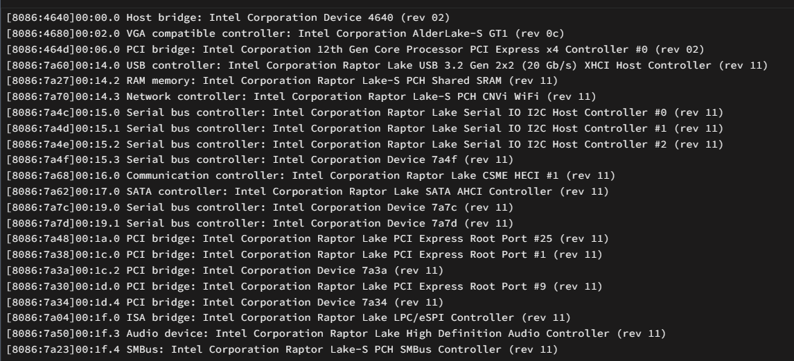

Following up on this, I am curious if somehow my unraid configuration files are not correct. Still struggling to go transcoding working right, but i have been poking around on the server and noticed in my devices it keeps listing the previous iGPU from my last build... I attached a screenshot, I feel like that should be the case, but trying to find other 14thgen build info posts is proving hard to come by.
I just find it weird that everything else is showing Raptor Lake, except for the VGA on line 2.

I think the gpu reports as alderlake as it is the same uhd770 built for alderlake and is used in raptor lake

So I think from the research I did after my post, it really is an AlderLake iGPU and you dont really need it to read raptor lake on the 14500, beacuse it isn't the actually the updated iGPU that came on the higher end chips, IE 14600 and above.
