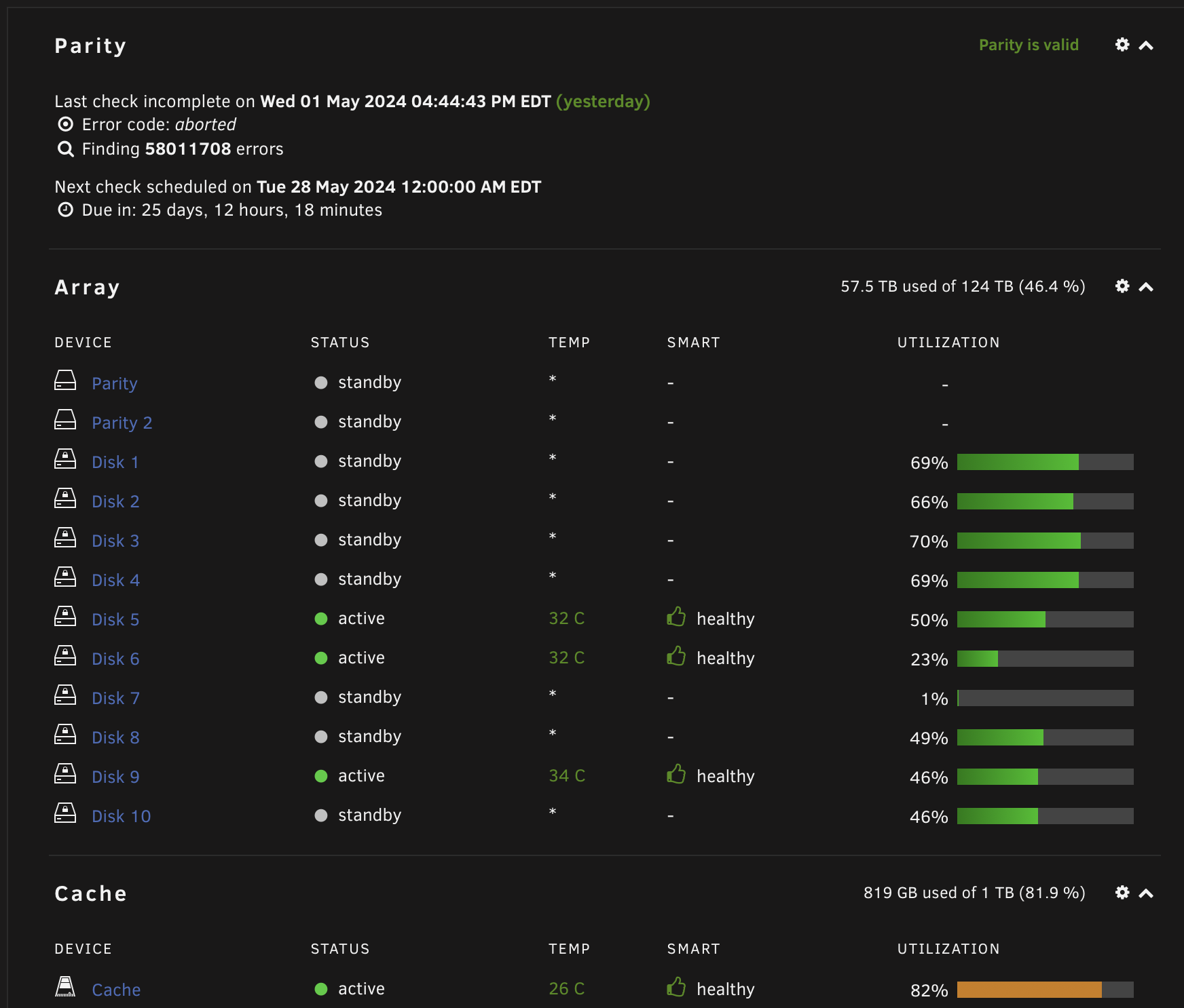

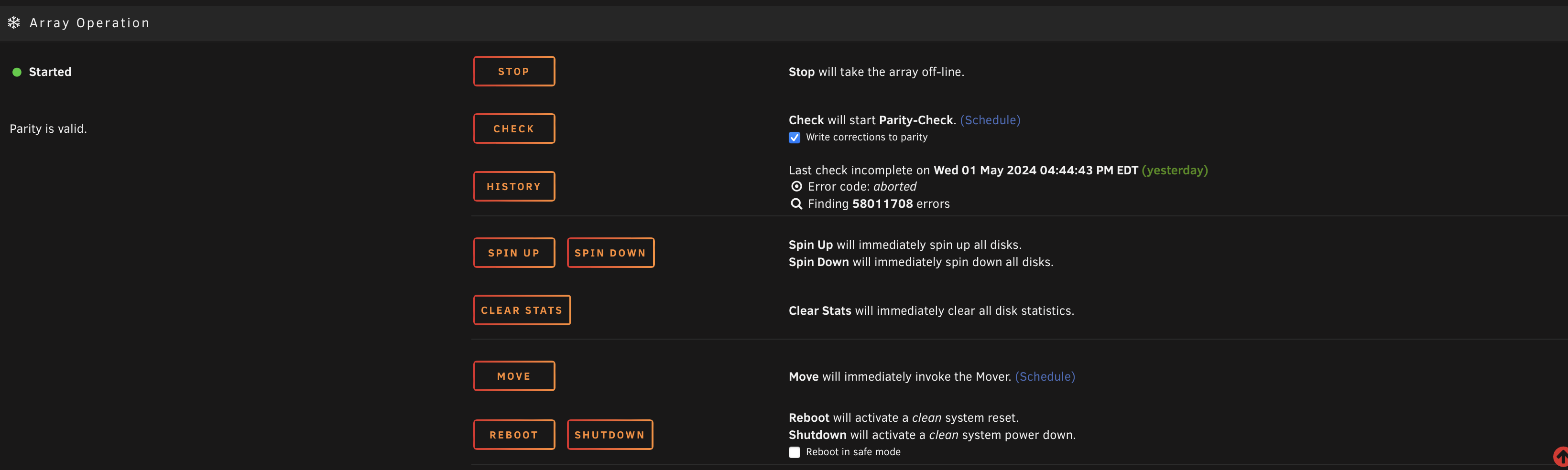

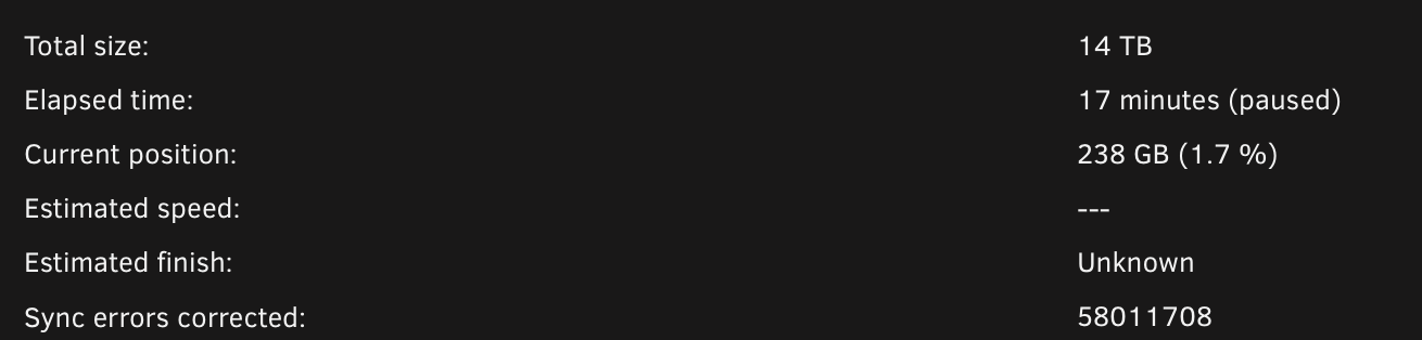

Parity-check ran as scheduled and started populating millions of errors. What does this mean? Did I just lose all my data? I am kinda nervous about this.

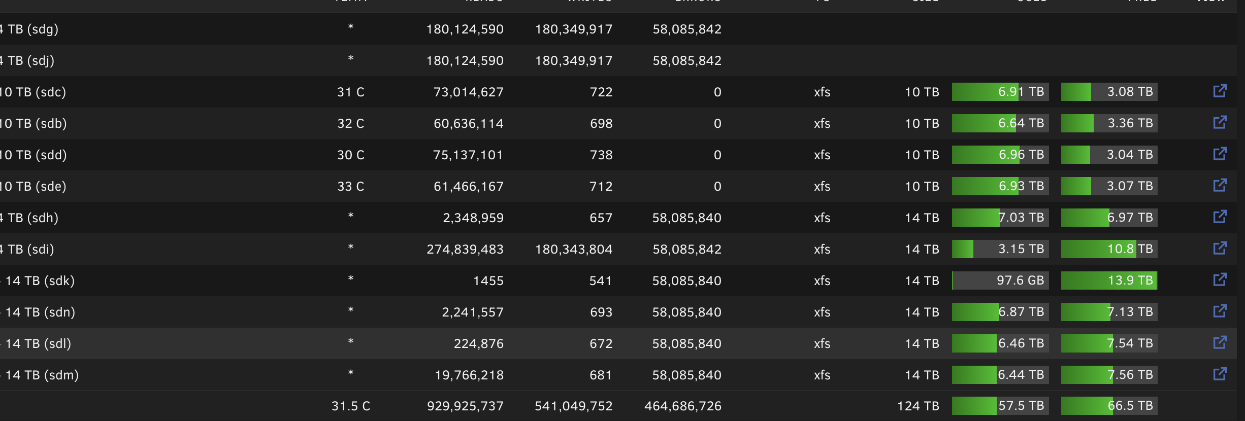

Since according to the screenshot you got errors on multiple drives then it seems that something common to those drives is probably the problem (e.g. PSU, HBA).   How many drives do you have - there seem to be more in the screenshot than I could see in the diagnostics.
the diagnostics you posted seem to have been taken immediately after a reboot and therefore show no sign of the problem since logs are reset after a reboot.
I have 12 drives. I took the diag right after I stopped the parity check cause I freaked out cause it was doing the "write corrections to parity" thing. The system hasn't been rebooted for 24 days.

Looks like a controller problem, reboot and post new diags after array start
So started it up. Was missing all the drives but the ones connected to the MB directly. Saw JorgeB's message and decided to reseat the HBA - and it now seems like things are back to 'normal' but I still have the millions of errors. What should I do about this? Do I do a parity-error check but don't do the write corrections?

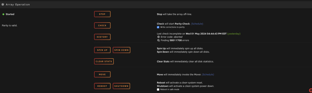

Where are you seeing errors? Syslog is clean so far.
I am seeing the errors on my main screen and under the 'main' tab.
That's from the last check, run a new one now.
