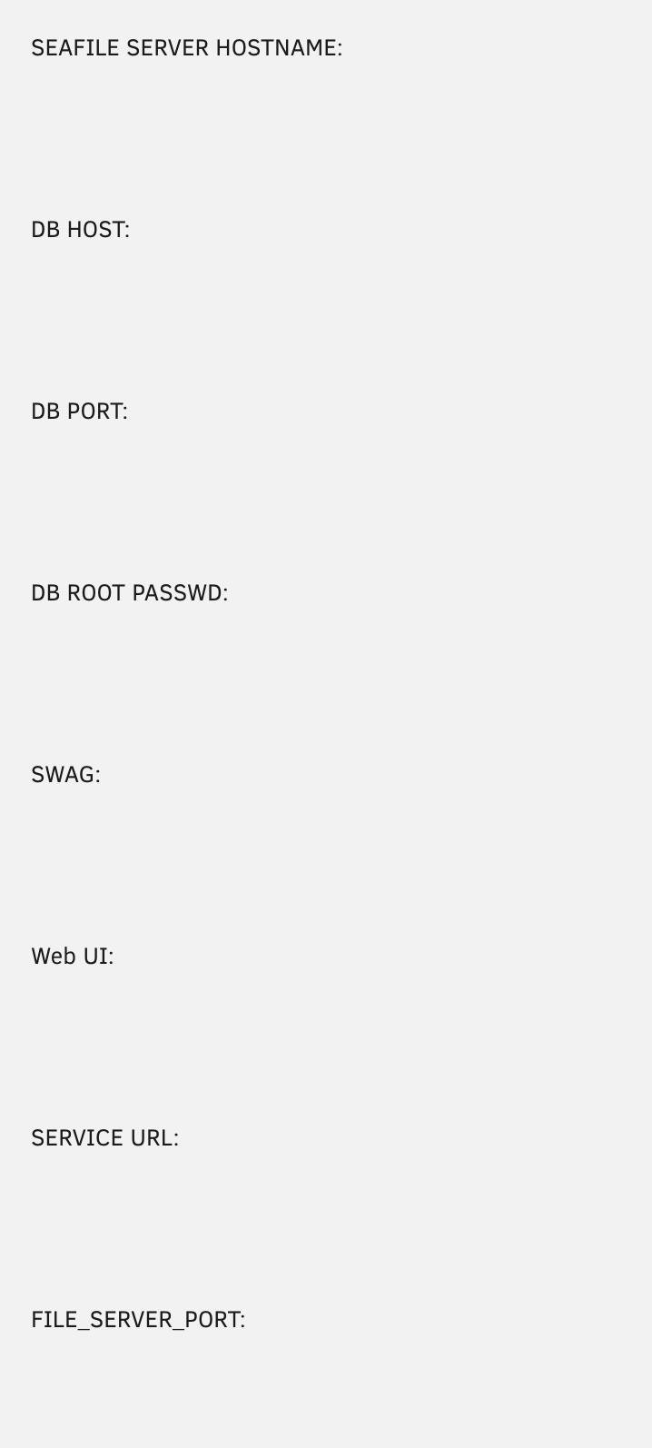

August 13, 20242 yr After 6 days and over 30+ hours I was about ready to give up when I FINALLY was able to get Seafile (specifically uploads/downloads) working with SWAG. Huge shout out to user tubezleb for providing this solution on GitHub. I did using the official image and following some of the context in this guide. I created a file called seafile.subdomain.conf and the only change I needed to make in this was to update the server name to match my domain. I also had to update the port from 8000 to my port number since 8000 is already in use on my server in the proxy config. I also had to add several variables to the container that I attached in the screenshot. Last thing, in the /seafile/conf directory created after you hit apply I needed to update the web ui port in the following files (this only matters if you don't use port 8000): gunicorn.conf seafdav.conf seahub_settings.py Total sidenote, email notifications started working after I got the file server working. Follow this guide here. Hope this helps someone.
