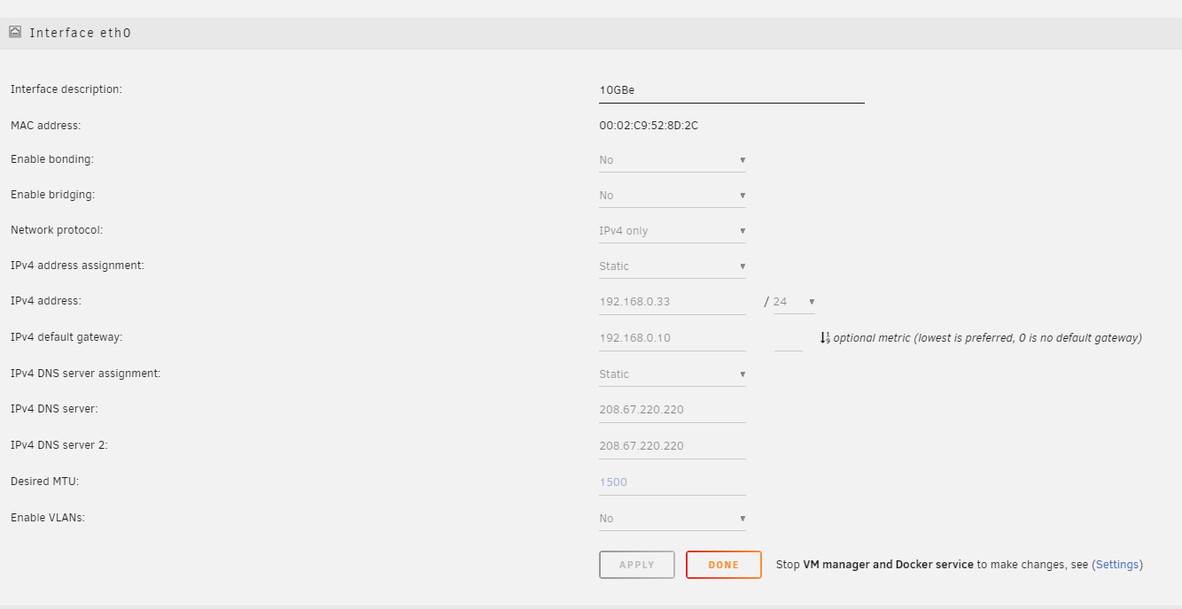

1, 10GBe for unraid and everything else on 192.168.0/24 (eth0) Gateway 192.168.0.10 (Sophos)

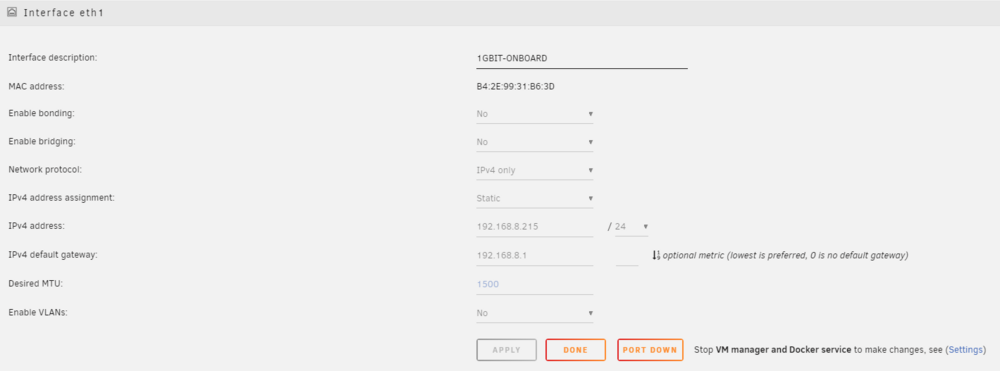

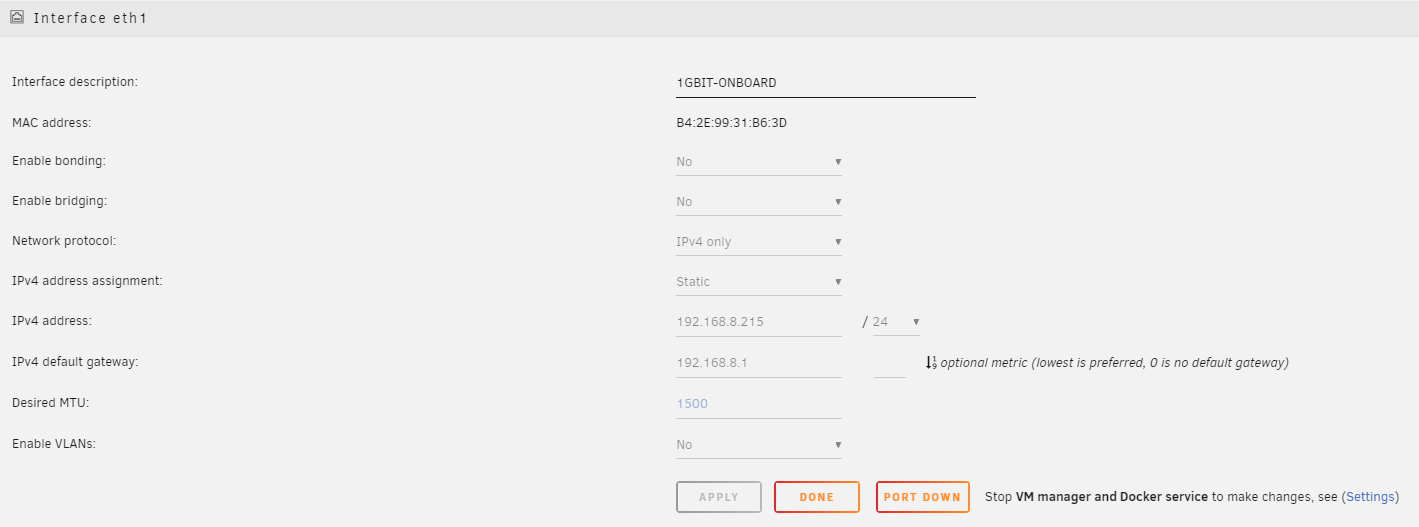

2, 1GBIT-ONBOARD for the 5G router (192.168.8.0/24 (eth1) Gateway 192.168.8.1
I need to be able to access both ip ranges for lan access to the dockers (although I can currently only access 192.168.8.0/24 from 192.168.0/24 it doesn't work the other way around, it would be great if they could access each other!)

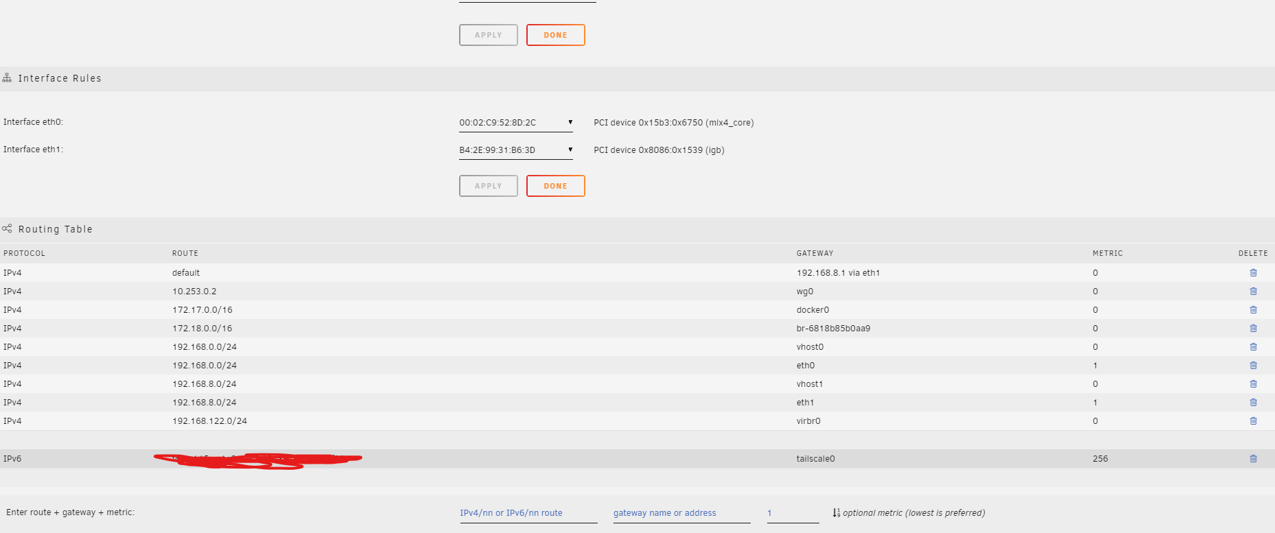

The problem I have is that although the dockers are working great using the new 5G router but for some reason the whole unraid server and all dockers are using the 5G router gateway?
As you can see, the 10GBe interface is set to use the DSL on eth0 but for some reason it is using 5G router on eth1?

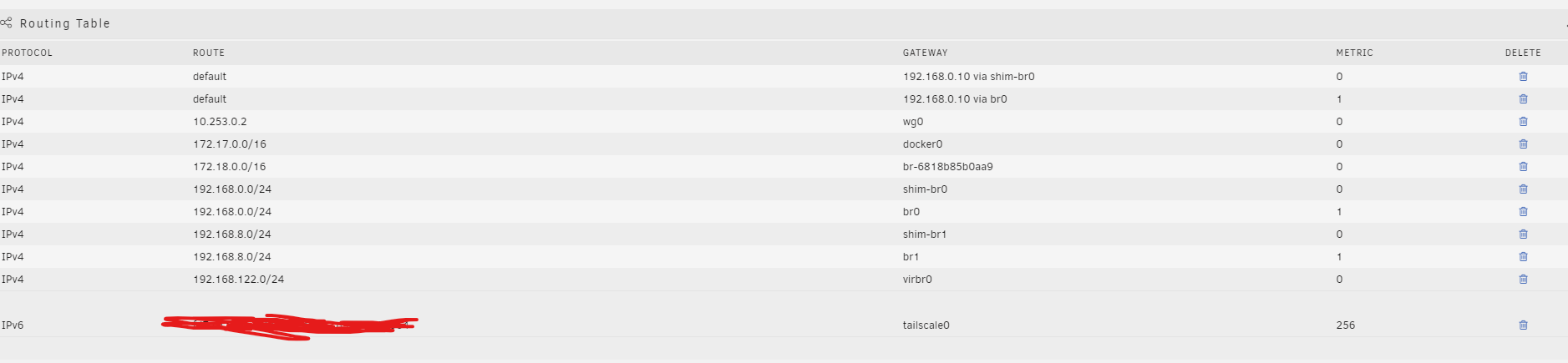

ok! Update, despite hours of googling before posting, I found a discussion on metrics straight after!
This is my new routing table and it appears to now be working as intended!
All except being able to communicate with 192.168.0/24 from 192.168.8/24 (eth1 to eth0) can anyone help with this please?  I am able to do the reverse no problems.
