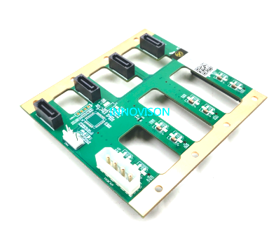

they are currently connected to a sata backplane that I have 2 x replaced recently, could this be the problem?
It could, you can try connecting them directly.
after troubleshooting, i switched out the psu and everything is working fine after the rebuild, thanks for the tip!
