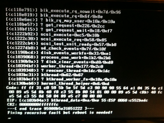

Hi all,
Hope you can help. My server seems to lock-up roughly every 12 hours or less. At that point I cannot telnet, use the browser - emhttp, or use the console directly.
I could not capture syslog but did capture a screen shot of the console, apologies, quality is not fantastic!
Can you let me know if there is anything else I can do other than the steps below to isloate the problem? Thankyou all!

An extended tail and a larger console would probably be your best bets, for more diagnostic info.  I use the command:
  tail -f --lines=120 /var/log/syslog
This makes the last 120 lines available, using the Shift-PgUp key combo to page up through the last pages of the syslog.
I also adjust the console screen lines to 80X60, to make 60 lines visible, rather than the meager 25 lines default.  To do this, add the VGA=6 parameter to the append line of your syslinux.cfg file.  For more info on this, see here.
About the only thing you can do with kernel panics is either remove the offending hardware, if that seems indicated, or use a different kernel.  You might want to try different kernels, either the newer Linux v3.1.1 in v5b14 or the older kernels in v5b12 or older.

Running with 4gb RAM which should be more than enough and overnight memtest showed no errors so guessing not a ram issue.

Your tail is showing some serious issues, possibly the cause of the system crashes you have experienced.  There are actually 2 issues present, neither of which I have the experience to help you.  The first appears relatively minor, but involves the Apple support, so perhaps someone with Apple experience can help with that.  The more serious is the issues with rsync and glibc, and requires someone with considerably more Linux experience.  Just guessing here, but there may be a conflict between the libraries included with this distro (v5b13) and libraries included with some of your addons.  A possible solution would be to revert to older kernels, with hopefully more compatible libraries.  Better Linux experts could give you better advice.
Since the conflicts and issues appear when rsync was called by the mover, another partial and temporary solution would be to disable the mover.  If nothing else, disabling the mover and avoiding any use of rsync should help confirm if that is the cause of the system crashes.
