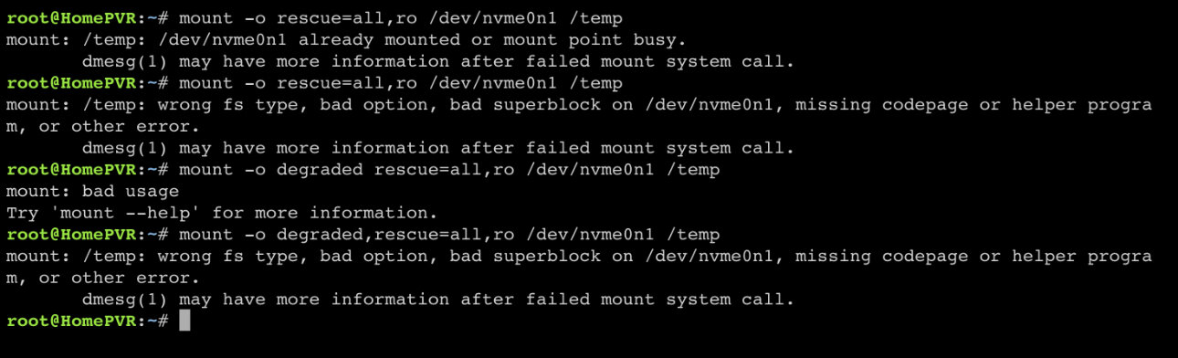

yea I followed that post found it after I’d put mine but it doesn’t work so I’m guessing I’ve lost everything from it not the end of the world my own fault for not doing backups of the app data still not fully got used to unraid for the amount of time I’ve had it. Or Im doing something wrong not sure. Does this like write on the image attached
You need to specify the partition:
/dev/nvme0n1p1
/dev/nvme0n1p1

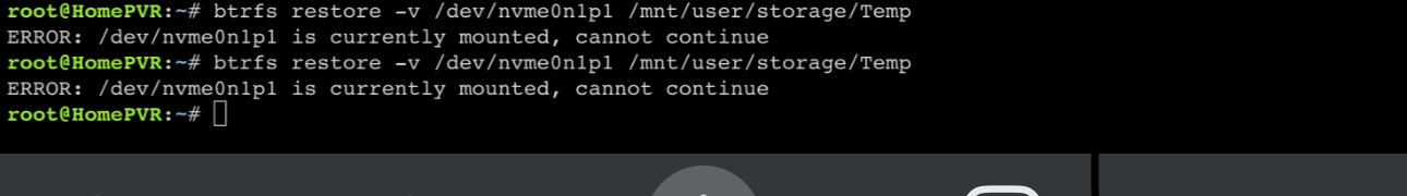

Thank you so when I’ve added p1 to the rescue all one to the temp folder this time I got no messages and it just came back to my root line. Does this mean stuff has worked if so were would the data be for me to look at cheers. I tried the backup one further down and it says it’s allready mounted now. IMG_0164.thumb.jpeg.7ce7c522c15785af5cd1468ebd5a9be9.jpeg
Thanks I’ve figured it out finally and btrfs has been running now for a while and I can see data getting transferred over soon as it’s finished I’ll install my new cache drive and transfer it back. Will remember to create backups from now on ha
