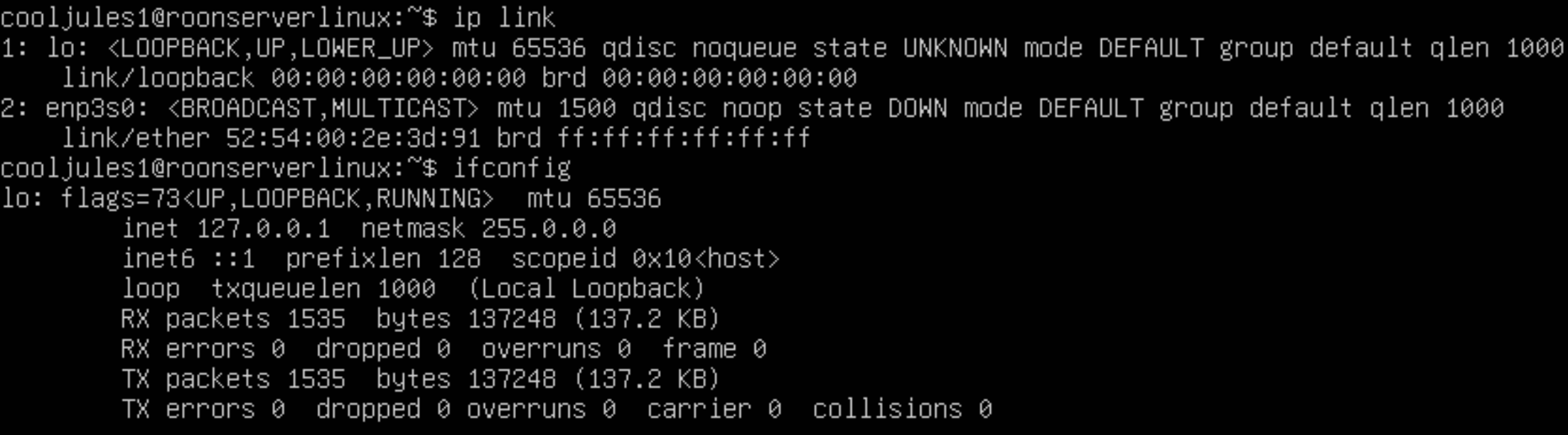

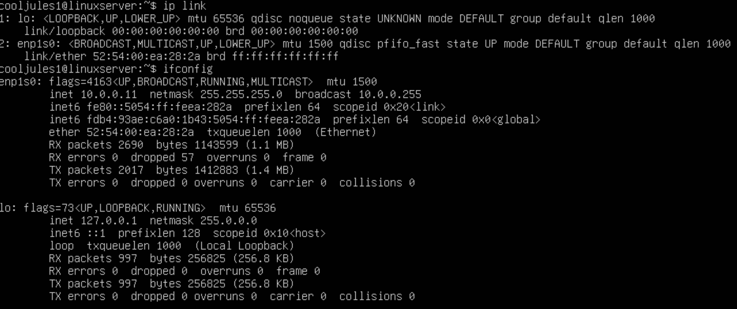

Here's my network before adding unRAID shares:

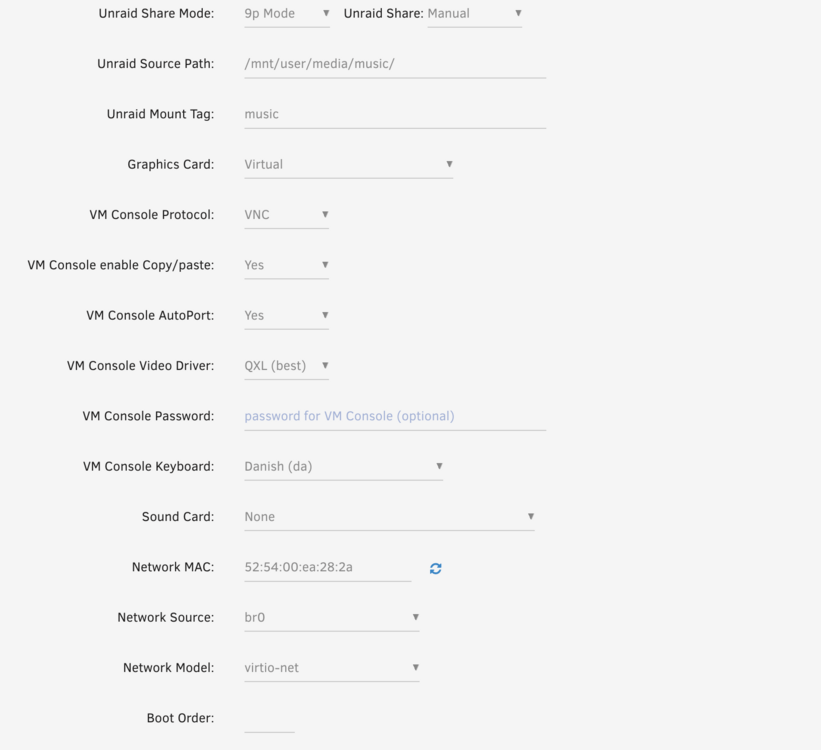

After adding unRAID shares:

Any help is greatly appreciated.

    <filesystem type='mount' accessmode='passthrough'>
      <source dir='/mnt/user/media/music/'/>
      <target dir='music'/>
      <alias name='fs0'/>
      <address type='pci' domain='0x0000' bus='0x01' slot='0x00' function='0x0'/>
    </filesystem>
    <interface type='bridge'>
      <mac address='52:54:00:ea:28:2a'/>
      <source bridge='br0'/>
      <target dev='vnet8'/>
      <model type='virtio-net'/>
      <alias name='net0'/>
      <address type='pci' domain='0x0000' bus='0x03' slot='0x00' function='0x0'/>
    </interface>

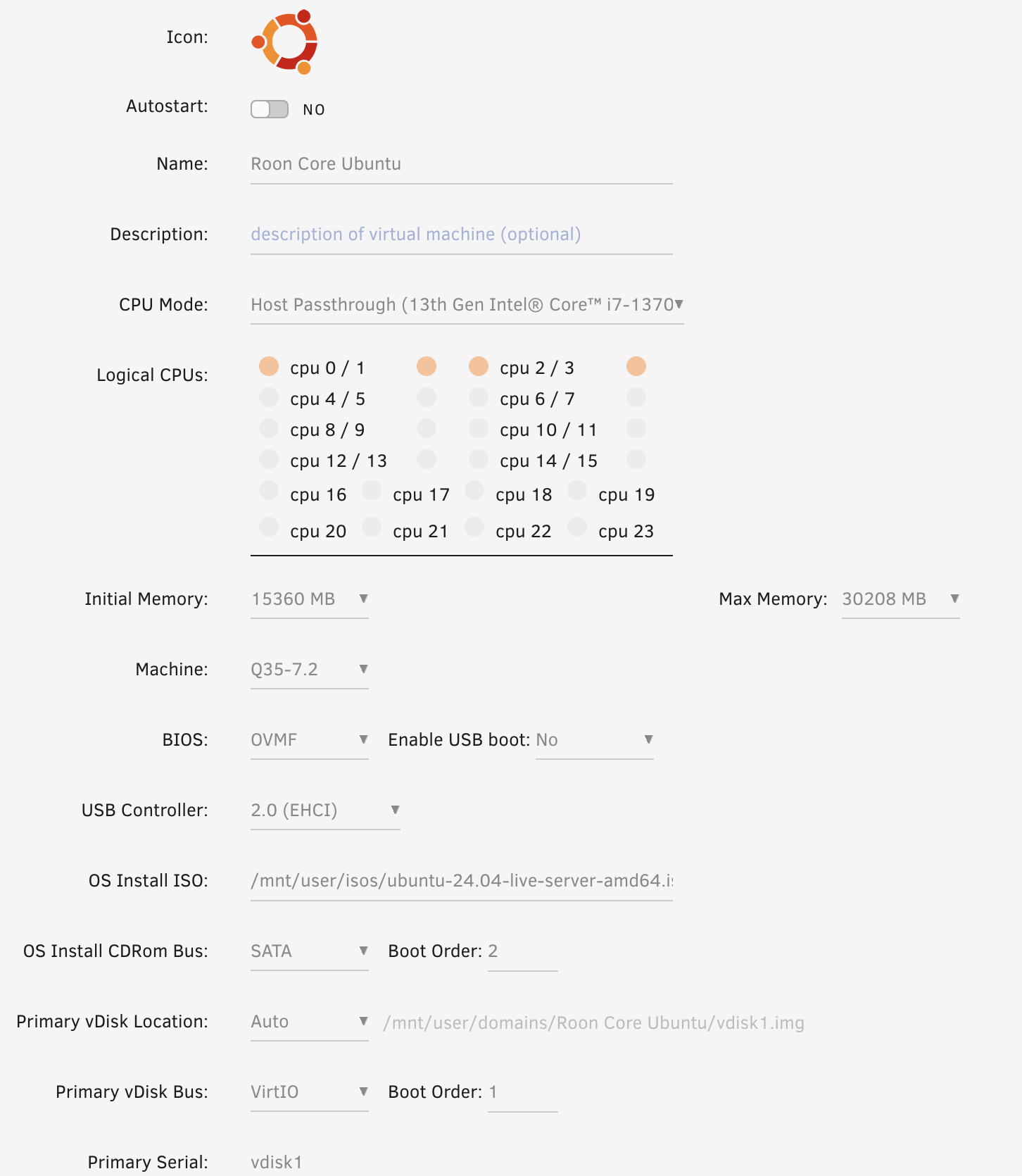

Here is the VM config
